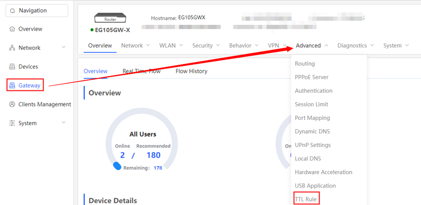

You can configure the TTL rule on the Reyee gateway
1.Click[Gateway]-->[Advance]-->[TTL Rule]

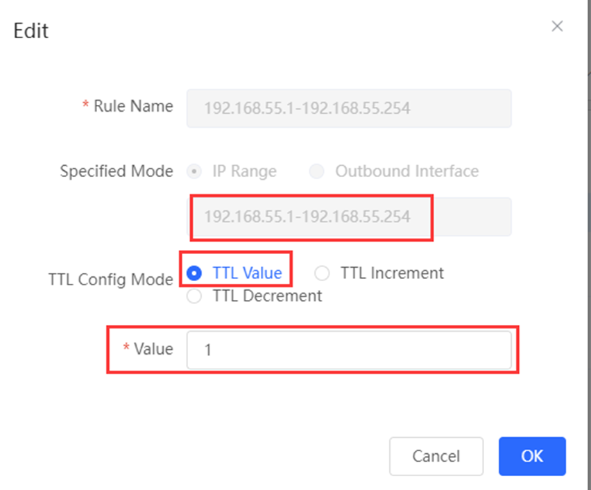

2.
(1
).        Input the address segment that you don't want authentication users to share the network via the hotspot
(2
).        Configure the TTL Value to 1

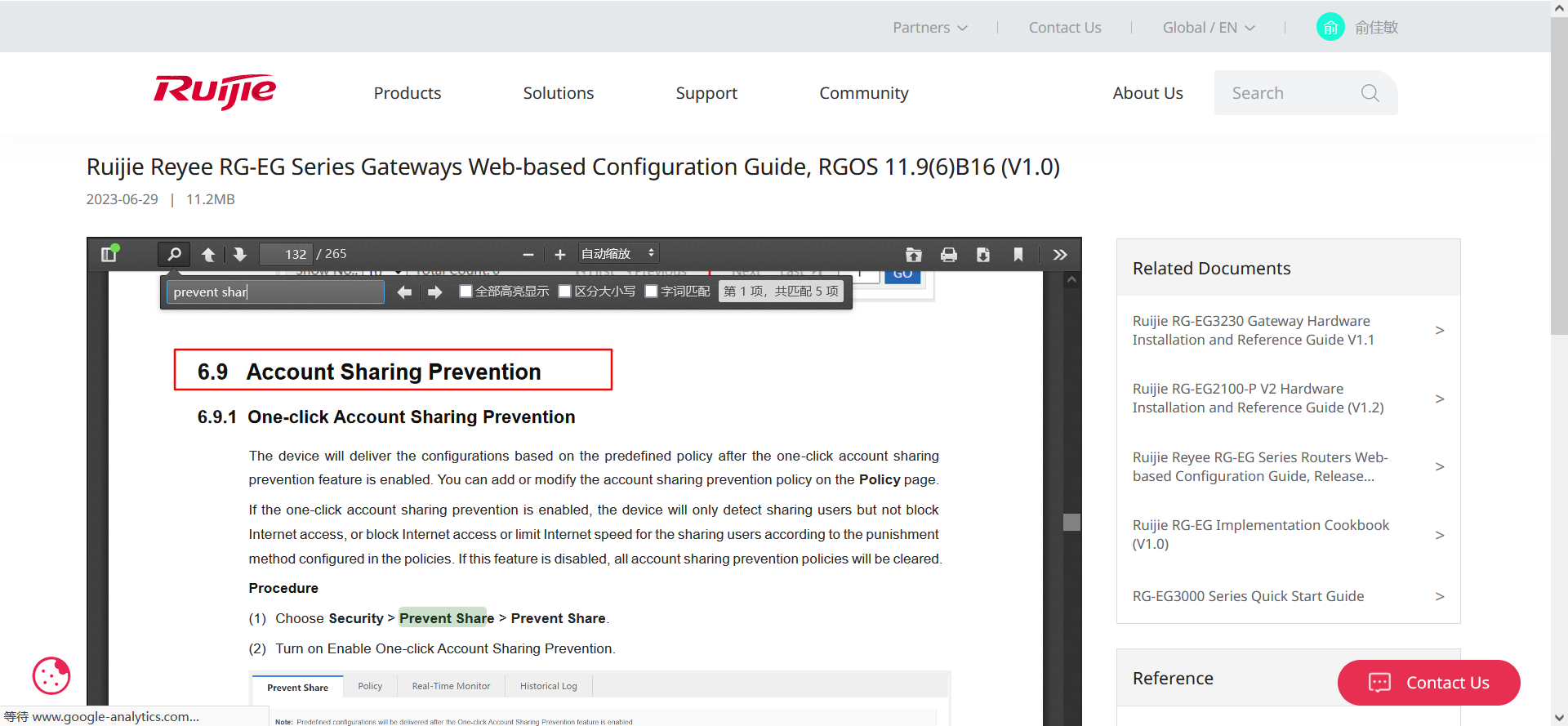

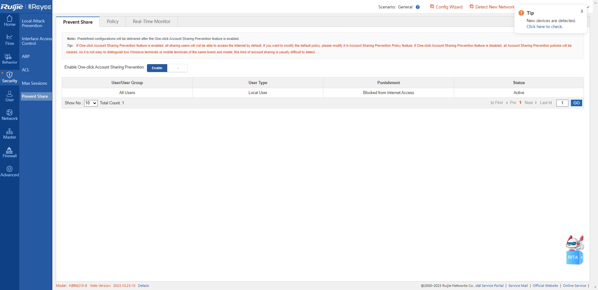

You can configure prevent share on Ruijie EG on this page:
You can also refer to this guide on page 132: https://www.ruijienetworks.com/resources/preview/ruijie-reyee-rg-eg-series-gateways-web-based-configuration-guide-B16
