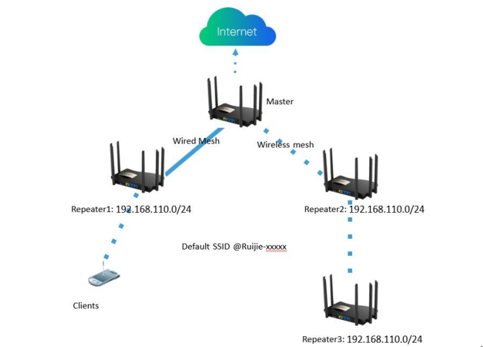

Here is the topology:
a)  Master must meet two conditions:
1) Finish the quick setup
2) The WAN port is connected and the interface indicator is on.
b) Slave must meet two conditions:
1) Slave is the factory state;
2) Slave is within 3 meters from the master and is unobstructed (ensure the signal strength is above -35)
c) Both the master and slave are powered on
Press the reset button of the master, and the indicator light will flash quickly. After 1-3S, the slave indicator will start to flash quickly. After the indicator lights of the slave and slave are always on again, the wireless mesh is successful.
Verification
Then take the slave to the place where you need to use it and wait for the indicator light to stay on.
