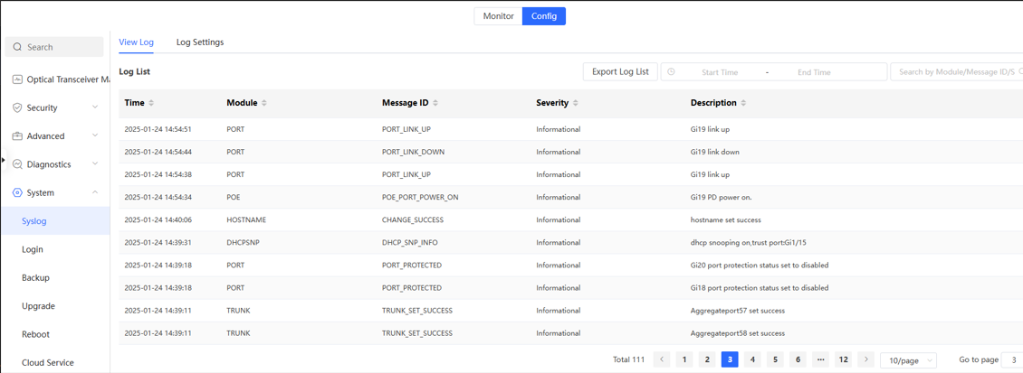

Dear customer,
You can follow the steps below to troubleshoot this issue.
1. Check the syslog in your PoE switch. If there is any log indicates the uplink port was down. If the uplink port has been down, check if the cable on it is contacting well.

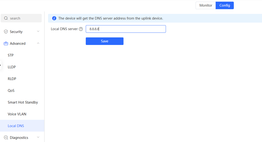

3. If the gateway of you network has more than 1 ISP on the WAN ports, make sure the Local DNS on your NBS is set to 8.8.8.8 to ensure the cloud service URL is parsed correctly.
