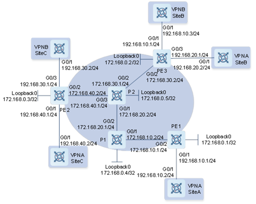

Requirements
1. Users of different SITs within a VPNA can communicate with each other.
2. VPNB users of different SITE can communicate witheach other.
3. Users between VPNA and VPNB VPNs cannot communicatewith each other.
Topology
Configuration

(5) configure EBGP between each PE and VPN-SITE to transmit VPN routing information.
#Configuration of device PE1.
PE1 (config) #router bgp 1
PE1 (config-router) #addresses-family ipv4 vrf VPNA
PE1 (config-router-af) #neighbor 192.168.10.2remote-as 65001
PE1 (config-router-af) #neighbor 192.168.10.2activate
PE1 (config-router-af) #exit-addresses-family
PE1 (config-router) #end
#Configuration of device PE2.
PE2 (config) #router bgp 1
PE2 (config-router) #addresses-family ipv4 vrf VPNA
PE2 (config-router-af) #neighbor 192.168.40.2remote-as 65003
PE2 (config-router-af) #neighbor 192.168.40.2activate
PE2 (config-router-af) #exit-addresses-family
PE2 (config-router) #addresses-family ipv4 vrf VPNB
PE2 (config-router-af) #neighbor 192.168.30.2remote-as 65005
PE2 (config-router-af) #neighbor 192.168.30.2activate
PE2 (config-router) #end
#Device VPNA-SITEA configuration.
VPNA-SITEA > enable
VPNA-SITEA #configure terminal
VPNA-SITEA (config) #interface gigabitethernet 0/1
VPNA-SITEA (config-if-GigabitEthernet 0/1) #noswitchport
VPNA-SITEA (config-if-GigabitEthernet 0/1) ipaddress 192.168.10.2 255.255.255.0
VPNA-SITEA (config-if-GigabitEthernet 0/1) exit
VPNA-SITEA (config) #router bgp 65001
VPNA-SITEA (config-router) #neighbor 192.168.10.1remote-as 1
VPNA-SITEA (config-router) #neighbor 192.168.10.1activated
VPNA-SITEA (config-router) #end
#Device VPNA-SITEB configuration.
VPNA-SITEB > enable
VPNA-SITEB #configure terminal
VPNA-SITEB (config) #interface gigabitethernet 0/1
VPNA-SITEB (config-if-GigabitEthernet 0/1) #noswitchport
VPNA-SITEB (config-if-GigabitEthernet 0/1) ipaddress 192.168.20.2 255.255.255.0
VPNA-SITEB (config-if-GigabitEthernet 0/1) exit
VPNA-SITEB (config) #router bgp 65002
VPNA-SITEB (config-router) #neighbor 192.168.20.1remote-as 1
VPNA-SITEB (config-router) #neighbor 192.168.20.1activate
VPNA-SITEB (config-router) #end
#Device VPNA-SITEC configuration.
VPNA-SITEC > enable
VPNA-SITEC #configure terminal
VPNA-SITEC (config) #interface gigabitethernet 0/1
VPNA-SITEC (config-if-GigabitEthernet 0/1) #noswitchport
VPNA-SITEC (config-if-GigabitEthernet 0/1) ipaddress 192.168.40.2 255.255.255.0
VPNA-SITEC (config-if-GigabitEthernet 0/1) exit
VPNA-SITEC (config) #router bgp 65003
VPNA-SITEC (config-router) #neighbor 192.168.40.1remote-as 1
VPNA-SITEC (config-router) #neighbor 192.168.40.1activate
VPNA-SITEC (config-router) #end
#Device VPNB-SITEB configuration.
VPNB-SITEB > enable
VPNB-SITEB #configure terminal
VPNB-SITEB (config) #interface gigabitethernet 0/1
VPNB-SITEB (config-if-GigabitEthernet 0/1) #noswitchport
VPNB-SITEB (config-if-GigabitEthernet 0/1) #ipaddress 192.168.10.3 255.255.255.0
VPNB-SITEB (config-if-GigabitEthernet 0/1) #exit
VPNB-SITEB (config) #router bgp 65004
VPNB-SITEB (config-router) #neighbor 192.168.10.1remote-as 1
VPNB-SITEB (config-router) #neighbor 192.168.10.1activate
VPNB-SITEB (config-router) #end
#Device VPNB-SITEC configuration.
VPNB-SITEC > enable
VPNB-SITEC #configure terminal
VPNB-SITEC (config) #interface gigabitethernet 0/1
VPNB-SITEC (config-if-GigabitEthernet 0/1) #noswitchport
VPNB-SITEC (config-if-GigabitEthernet 0/1) ipaddress 192.168.30.2 255.255.255.0
VPNB-SITEC (config-if-GigabitEthernet 0/1) exit
VPNB-SITEC (config) #router bgp 65005
VPNB-SITEC (config-router) #neighbor 192.168.30.1remote-as 1
VPNB-SITEC (config-router) #neighbor 192.168.30.1activate
VPNB-SITEC (config-router) #end
