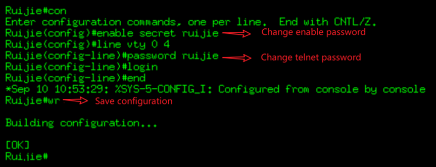

6) Change the password
3.Log in to the switch again with a new user nameand password to confirm that you can log in successfully
