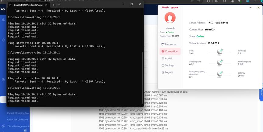

(1) A client successfully connects to an SSL-VPN server, but cannot access intranet resources.

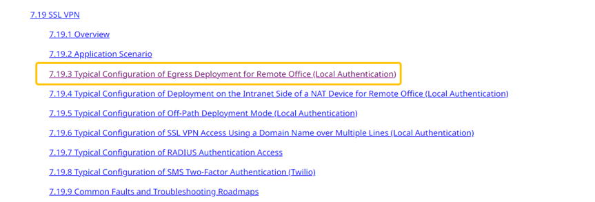

1. Click the following link to check the VPN configuration.
https://www.ruijienetworks.com/support/documents/slide_rg-wall-1600-z-s-series-cloud-managed-firewall-cookbook

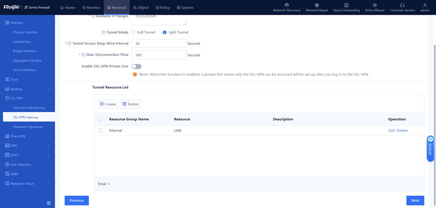

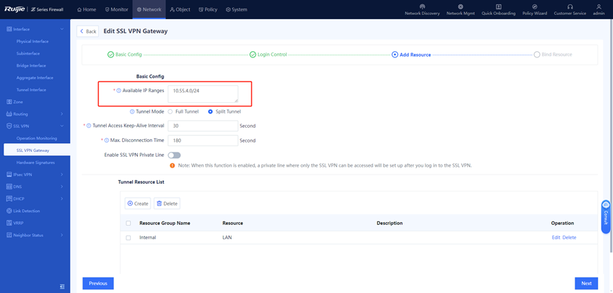

(1)SSL-VPN virtual address pool configuration

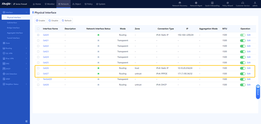

Note:The network segment of the virtual address pool cannot be the same as the address segment of physical interfaces on the firewall.

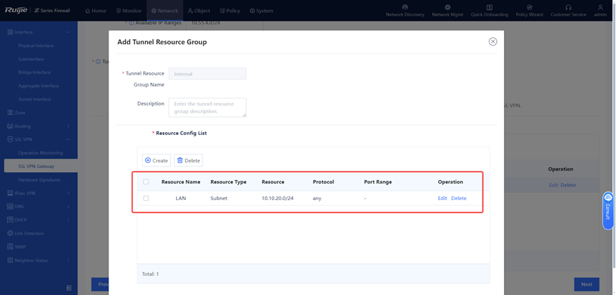

(2) Check the tunnel resource configuration. Configure the network segment to be accessed by the client and the related protocol or port.

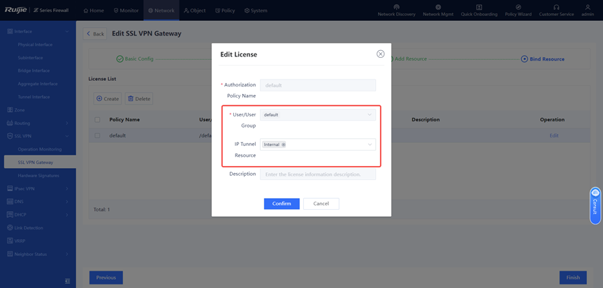

Bind the user group and resources.

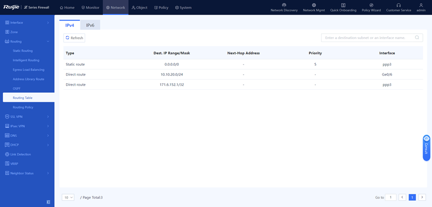

(3) Check the routing configurations to confirm whether routing table entries indicating an access to the internal resources exist. If not, add the entries; if the entries are incorrect, modify them.

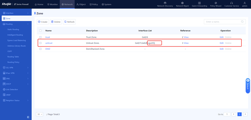

(4) Check the zone configuration and whether the untrust zone is bound to the following virtual interface. If not, the virtual gateway IP interface used by SSL VPN for client connections is not generated properly. This fault occurs when the virtual IP address pool conflicts with the physical port address ofthe firewall. You need to recreate an SSL-VPN gateway to rectify the fault. (This configuration is automatically generated after an SSL-VPN gateway is configured.)

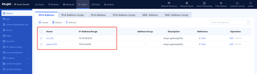

(5) Check whether the virtual IP address segment and the network segment of the intranet resources (which are automatically generated after an SSL-VPN gateway is configured) are correctly configured.

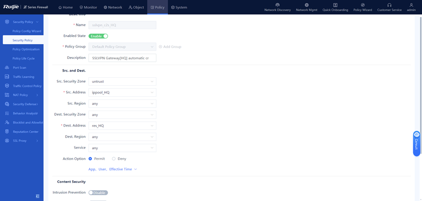

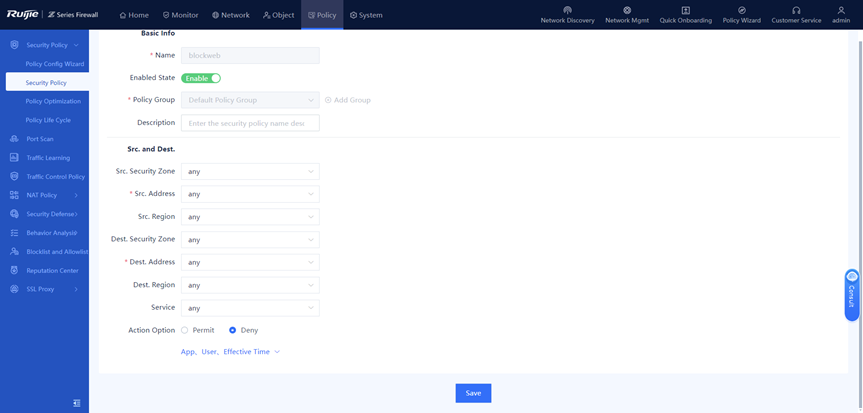

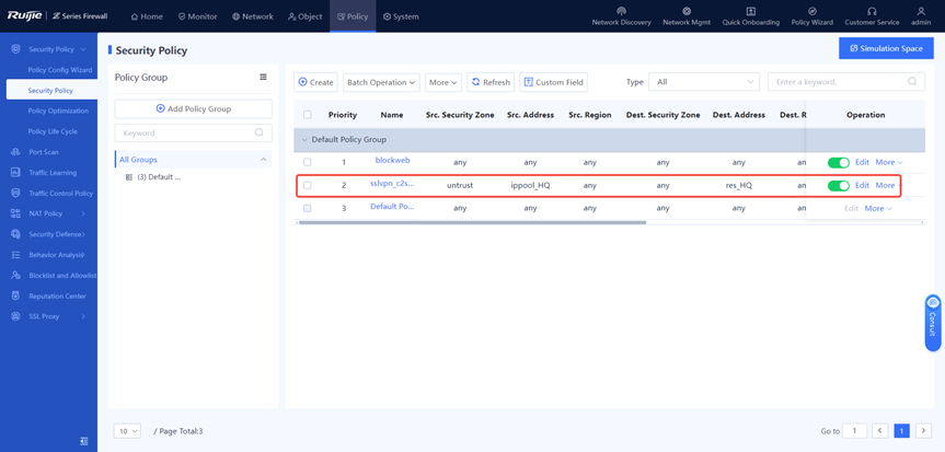

(6) Check the SSL-VPN policy. The following figure shows the proper configuration. (This configuration is automatically generated after an SSL-VPN gateway is configured. The SSL-VPN policy does not need to be manually configured. If an SSL-VPN policy is configured, the automatically generated SSL-VPN policy may be synchronized incorrectly.)

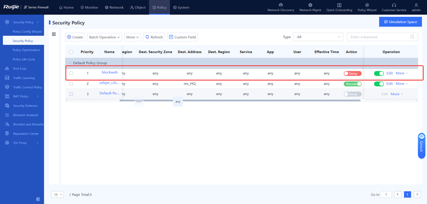

(7) Check the location of the SSL-VPN policy. If the first policy in the security policy list is "deny any any" instead of the SSL-VPN policy, the client initiating an SSL-VPN connection will match the first policy, and therefore will not be able to access intranet resources properly. Move the SSL-VPN policy above the first policy.
2. Check whether the firewall function is enabled on the intranet terminals to disable ping operations.
3. Check whether a subnet conflict (unilateral conflict, bilateral conflict) exists on both sides of the SSL-VPN connection.
(1) Unilateral conflict: An IP address or IP network segment conflict occurs on the firewall. (Confirm whether a conflict occurs by checking the logs, ARP information, MAC address information, and routing information of the intranet devices. If the devices are connected to Ruijie Cloud, use the AI Diagnostics feature to detect whether an IP address conflict exists.)
(2) Bilateral conflict: A subnet on the SSL-VPN client is the same as or contains the subnet on the peer end. (Check the address and routing entry configurations through the CMD on the PC.)
