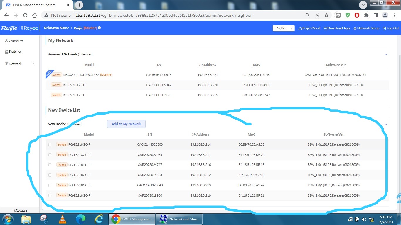

Hi,
I have added 2 out of 8 devices of RG-ES218GC-P
to RG-NBS3200-24SFP/8GT4XS
switch.
Unable to add the following 6 devices RG-ES218GC-P
. I have tried adding individuals from the 6 to no avail. I have keyed in the correct password for the device even the default (admin).
Please advise. Thanks

Hi Jayden,
The connection is only locally. It's not connected to the Internet.
Only 2 devices of RG-ES218GC-P are able to add to the network of RG-NBS3200-24SFP/8GT4XS. Could it be the firmware issues?
above photo. "Unable to add the following 6 devices RG-ES218GC-P"
Able to discover the following 6 devices RG-ES218GC-P on the Network but was unable to add to the Network.

1. Could you please test the connectivity between the master NBS device and the ES switches through ping? unable to ping ES switches.
2. May I please know if you are able to locally log in to the eWeb of the switches that could not be added into SON? I can log into individual ES locally to upgrade firmware and configure it Static IP Address.
3. If you are able to log in eWeb, please check the management password is the same and the vlan settings have been enabled. I am able to log in to eWeb of NBS. I have tried the management password (which I created) and default password (admin) to no avail. I am not creating any vlan at the moment.
