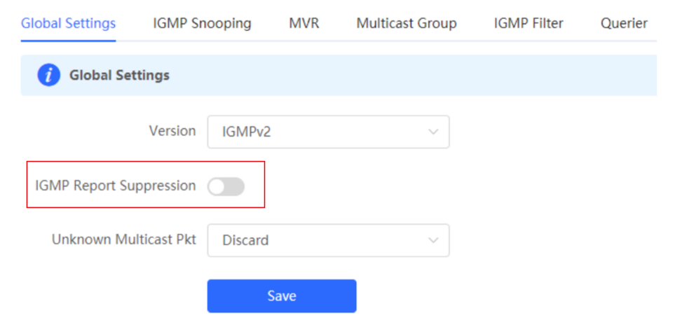

What is IGMP Report Suppression on ES series eweb? Reply
3020 0 2023-3-28 17:24:56
This function is enabled to reduce the number of packets in the network save network bandwidth to ensure the performance of the IGMP multicast device.   The switch forwards only one report packet to the multicast router if multiple downlink clients connected to the switch simultaneously and send the report packet to demand the same multicast group.
