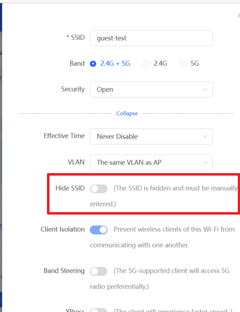

1. Cannot find Guest WiFi
You can check whether enable Hide SSID function

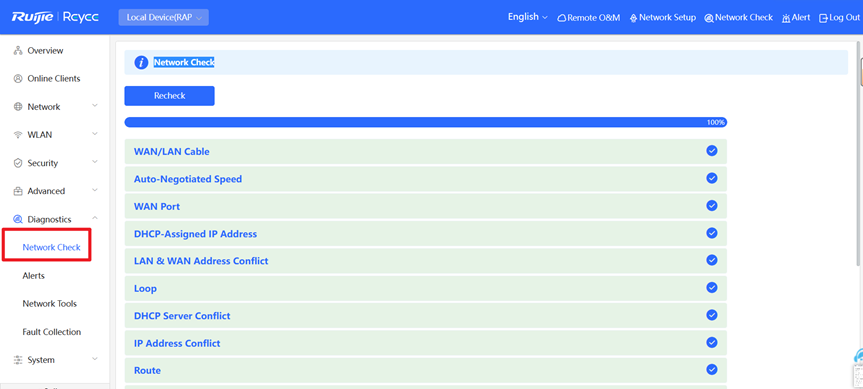

4. Unable to access the Internet after obtaining the address
1)Check whether the terminal can communicate with the DNS address. If not, tracert checks the destination hop
2)If the device is stuck to the egress device, check whether the egress device can access the Internet and whether NAT is enabled on the egress device. You can view the NAT flow table to check whether address translation is generated in the data and check the NAT policy
3)Check whether the Internet access blacklist and behavior policy are configured on the uplink device
4)Check whether policy-based routing is configured on the device to forward Intranet data to the interface that can not access the Internet
5)If DNS addresses are communicating properly and the domain name can not be accessed, check the DNS configuration or check whether the DNS port on the uplink device is blocked (53)
