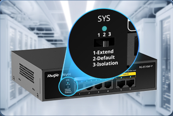

1. Certain models have a DIP switch which you can use to switch the working mode of the device:
a: Extend mode: The rate of LAN ports is reduced to 10 Mbps. Typically, the transmission distance is 200 m (656.17 ft), which is up to 250 m (820.21 ft) in the laboratory environment with Cat5e cables or higher. In addition, factors such as cable quality, powered device performance, and ambient temperature may causethe transmission distance to be less than 250 m (820.21 ft).
2.
The other models that support long-distance transmission but without the Extend mode have adaptive LAN ports. Changing the port rate on the the powered device to 10M and the long-distance transmission is automatically negotiated on theES100 switches.
Notice:
For detailed information regarding the DIP switch, please consult the hardware installation of corresponding device model.
