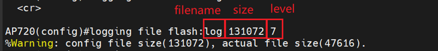

1. Save the log to flash
Ruijie#conf

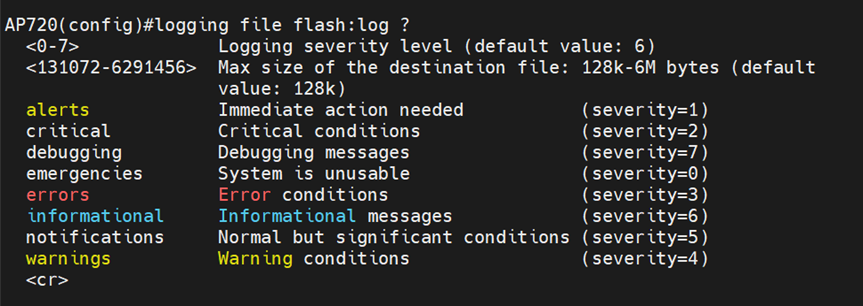

Ruijie(config)#logging file flash:filename[max-file-size] [level]
filename:
Log file name. The log file name does not contain a file type suffix. The suffix of the log file is fixed to *.txt. The suffix of the configuration file is rejected.
max-file-size:
The maximum size of log files is specified, range is 131072-6291456.
level:
The severity level of a log increases gradually. Level 0 to 6 indicates log information. Level 7 indicates debug information.

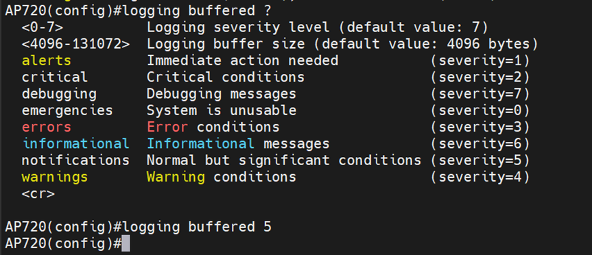

Ruijie(config)#logging buffered [level]

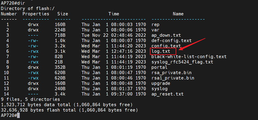

2. How to check logs saved to the flash:
Ruijie#dir

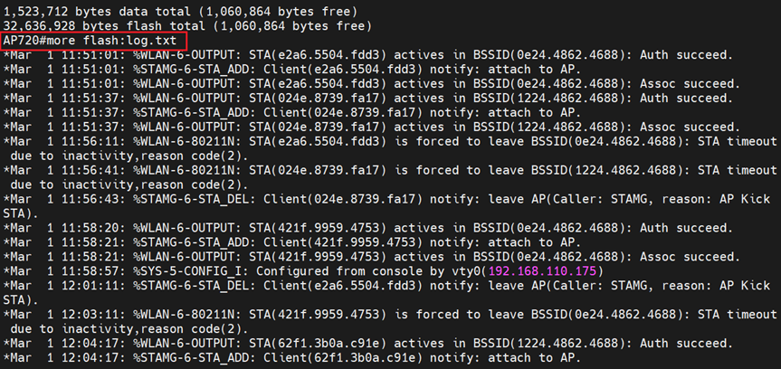

3. How to print log information:
Ruijie#more flash:log.txt
