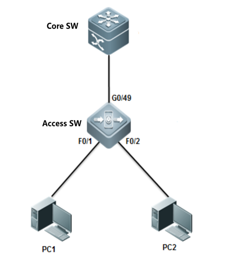

a) Requirement
The user gateway is on the core switch, the core switch creates a DHCP Server, the PCs connect to the access switch use dynamic DHCP to obtain IP address, in order to prevent ARP spoofing between downlinked users and downlinked users spoofing the gateway, use DHCP Snooping +DAI solution to solve the ARP spoofing problem.
b) Network Topology
Configuration Tips:
1. Enable DHCP Server function on the core switch (the user side may also use a dedicated DHCP server, the core switch only needs to enable DHCP Relay)
2. Enable dhcp snooping function globally on the access switch, and open the DHCP Snooping trust port on the uplinked core port.
3. Global DAI detection function is enabled, and the DAI Trust function is enabled on the uplink port.
4. Enable the IP Source Guard function on the interfaces connected to users
5. Adjust CPP limit and NFPP function, TRUNK reduction optimization
