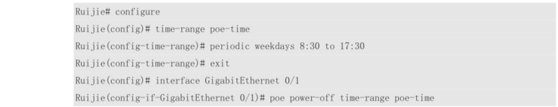

How to turn off PoE function of the interface for Ruijie device periodically?
3130 0 2022-7-5 11:43:36
Using the following commands to turn off the PoE function of GigabitEthernet 0/1 every day from 8:30 to 17:30
RG-S2900G-E V3
