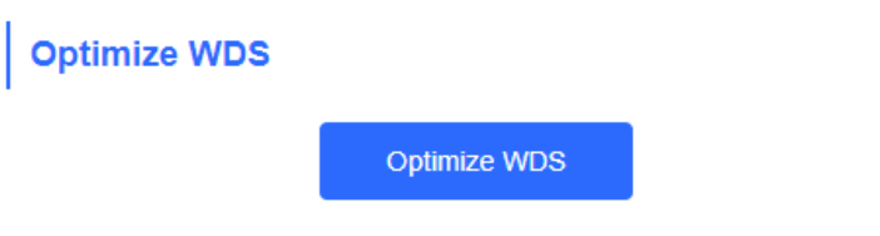

Choose Wireless>WDS> Optimize WDS. Click Optimize WDS so that the device automatically selects the channel again based on the interference in the current environment, ensuring that the device works in the optimal channel.  You are advised to optimize WDS when the original channel is not the optimum.
Note: After you click Optimize WDS, the NVR will be reconnected to the camera. Therefore, exercise caution when performing this operation.
