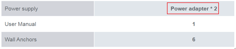

Does Reyee EST support PoE/PoE+ power supply? Reply
4634 0 2023-7-11 18:02:25
Sorry. The power supply on Reyee EST is passive PoE(Non-standard PoE), which means you can't power it by using PoE/PoE+ switch or adapter, or it will be burned out.
You should use the Power Adapter provided by Ruijie Networks.
