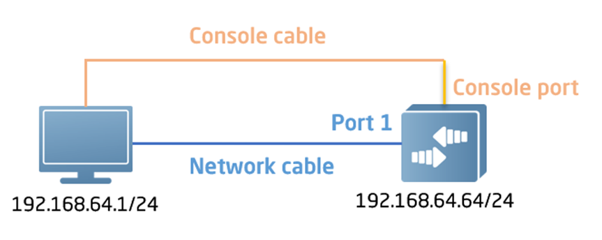

1. Connect console cable to the switch
2. Connect Ethernet cable to the first copper port or MGMT port( physical port doesn't linked up until data transfer starts, you also can not check ping connectivity during this process)

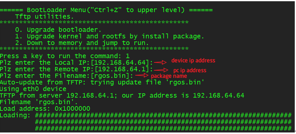

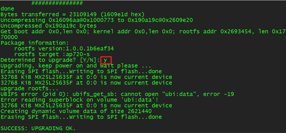

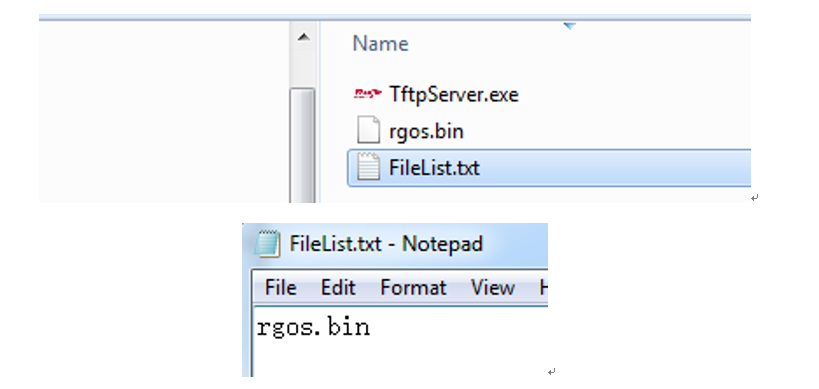

1.Assign IP address 192.168.64.1 to laptop, enable TFTP Server and also prepare the firmware, the firmware put on same folder with tftp server.
Notice: AP ip:192.168.64.64

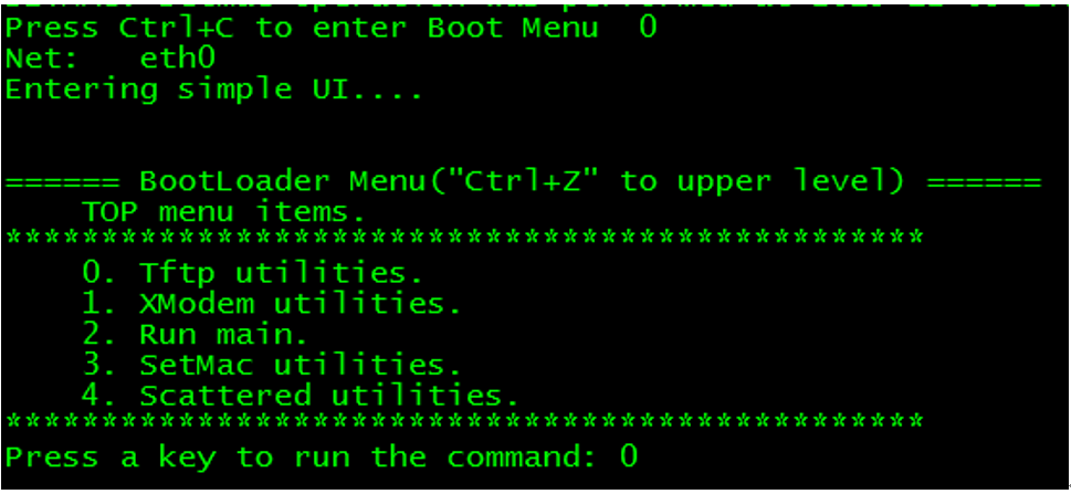

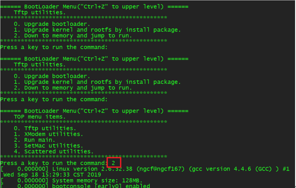

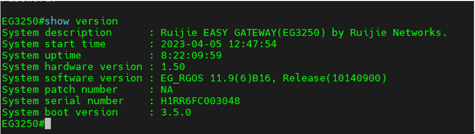

Press]
Devices succeed to enter Main mode, execute command "show version", check the firmware version. Ruijie#show version
<span style=""">
</span>
RG-EG3000XE
Configuration Router
