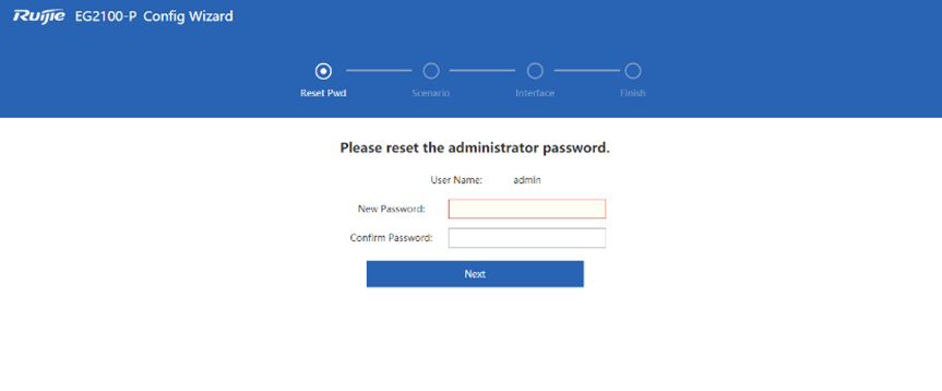

1) Reset Password:

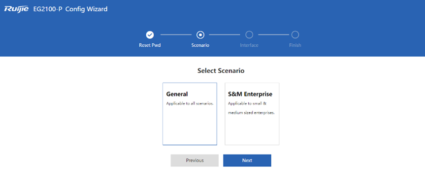

2) Select Scenario:

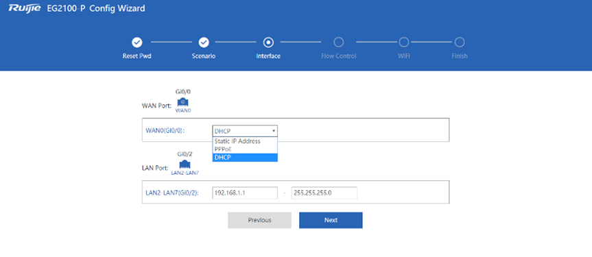

3) Configure Interface:

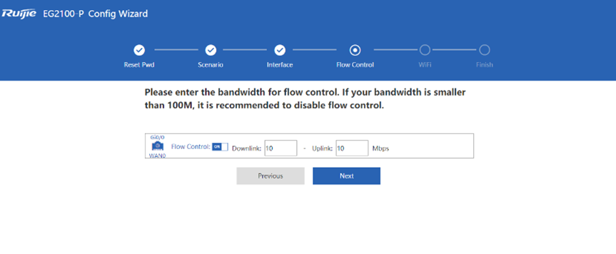

4) Enable Smart Flow Control:

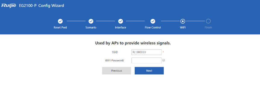

5) Configure Wi-Fi:

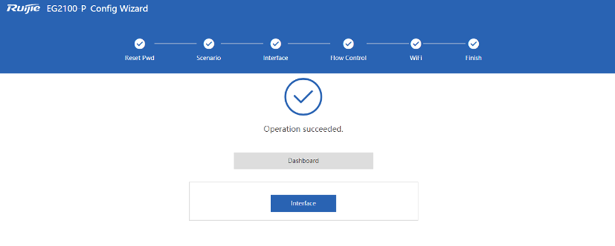

6) Save Configuration:
Note: Wi-Fi settings will be displayed only if the device supports Wi-Fi.
