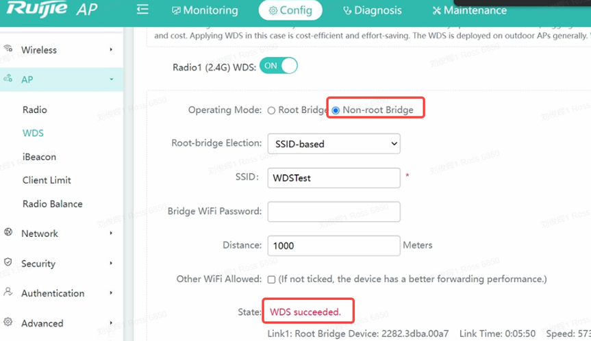

How to check the wds status ? Reply
4688 0 2023-8-9 17:03:30
You can Click [Config]-->[AP]--[WDS]
If WDS is built successfully, the State will succeed or it will be failed
RG-EST350
Configuration Wireless-Bridge
