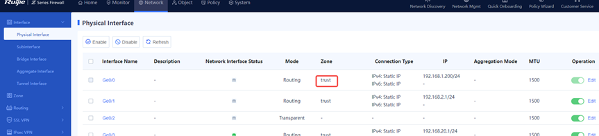

2.1.1 The physical interface is not added to the security zone, or the security zone configuration is incorrect.
>>> Locate the problem:
1. There is no session on firewall but can get the session message by capture the package.
2. The security policy of the session is uncorrect
>>> Solution
Add the physical interface to the security zone and set WAN port as “trust”and LAN port as “untrust”. If you have customized other security zone, pleasemake sure that the configurations of security zone of physical interface are rightand security zone is in the allowlist of security policies
