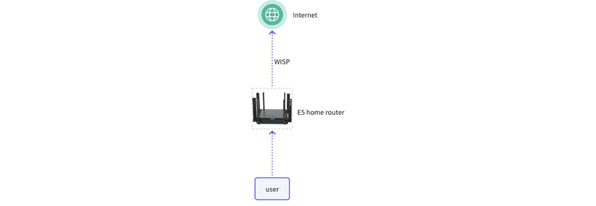

b) Network Topology

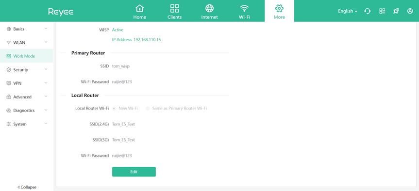

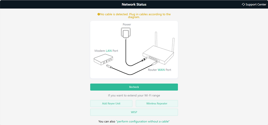

1
Select the connection mode as WISP
2

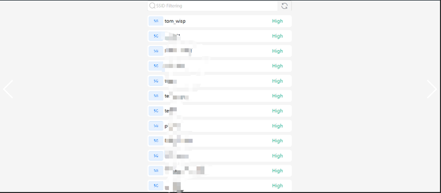

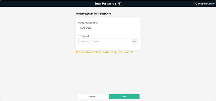

Connect to SSID

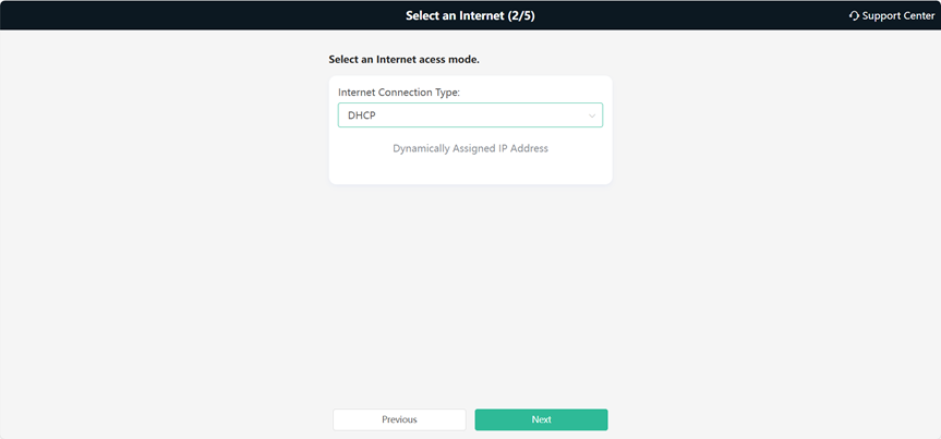

3) Select WISP access mode.

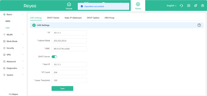

4) Create the SSID on the current router

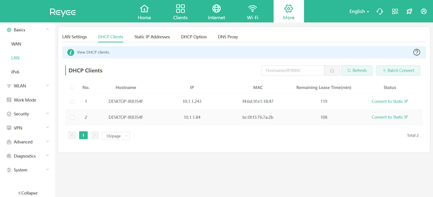

5) Configure the DHCP Server on the current router

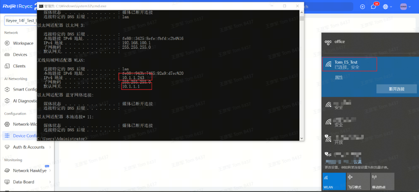

d) Test Result
