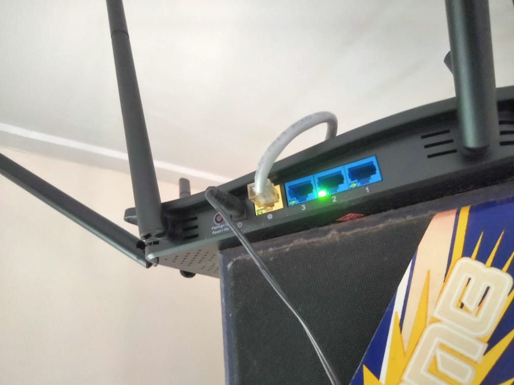

Hello I have problem on my EW1200G-PRO,
so the AP Router is like Hank/or something like not responding with indicator on WAN not light up but indicator on LAN2 on, I connected WAN to Ruijie ES220GS-P with poe disabled
after i reboot my AP and then works normally, after a while AP not responding with same indicator on LAN2
attached evidence on indicator lightup:

after changed my power adaptor, the device works properly and still monitored for stability 7x24H
