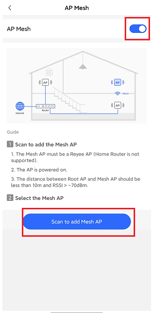

1. Enable the AP mesh in Cloud APP

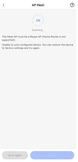

1.1 Enter the 'Tool Kit' page of project, then click the 'AP mesh' button to enter AP mesh configure page.
1.2 It's needs to make sure the AP mesh feature was enable firstly, then scan to add the AP for mesh. After that, the surrounding Reyee APs that support Mesh will be scaned. Then you can add then for Mesh.

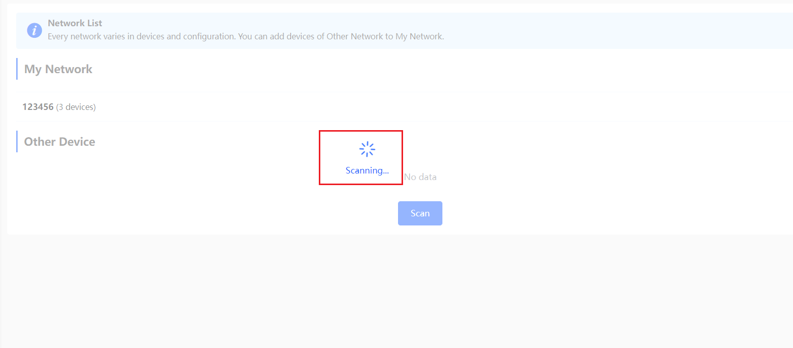

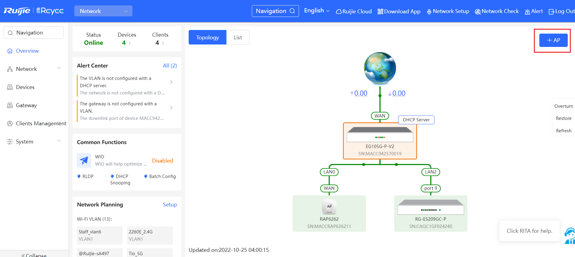

2. Enable the AP mesh in the local eweb of SON
2.1 Enter the eweb of master of SON, then click '+AP' button to  add the surrounding Reyee APs that support Mesh.

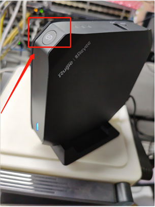

3. One-click pairing
One-click pairingrefers to enabling the mesh function on the Reyee EG device that supports thisfunction by pressing the mesh button. (Only EG105GW(T) supports the externalMesh button currently).
