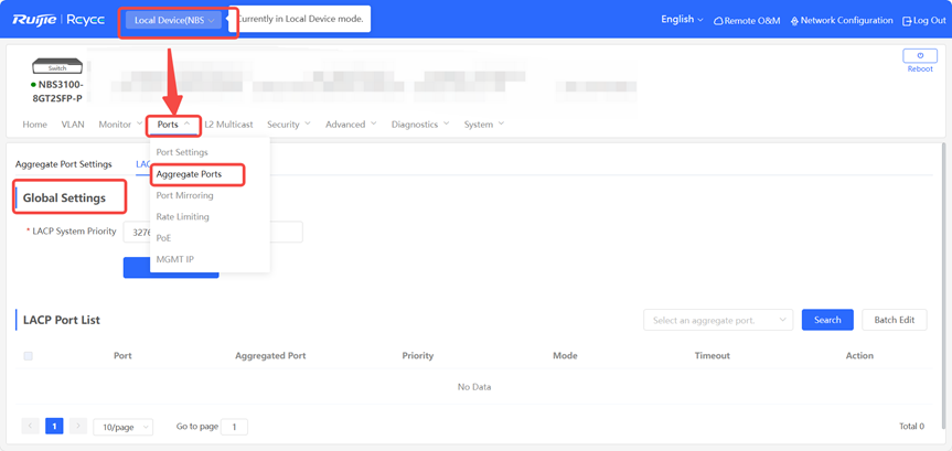

1. Enter the web of NBS locally or through cloud.
2. Choose Local Device > Ports > Aggregate Port > LACP Settings > Global Settings. Set LACP System Priority.
The value of system priority ranges from 1 to  65535, and the default value is 32768. The lower the value of system priority, the higher the device priority. When two devices have the same system priority, their MAC addresses are compared, and the device with the  smaller MAC address becomes the actor in the link aggregation group.

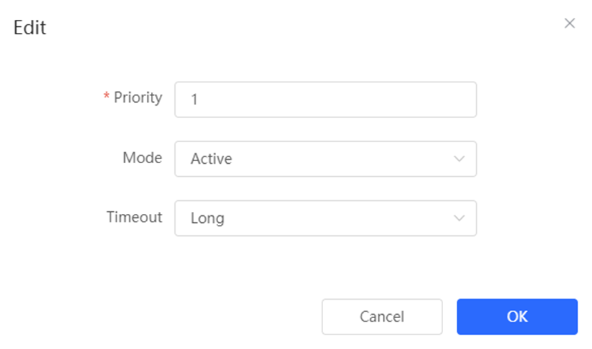

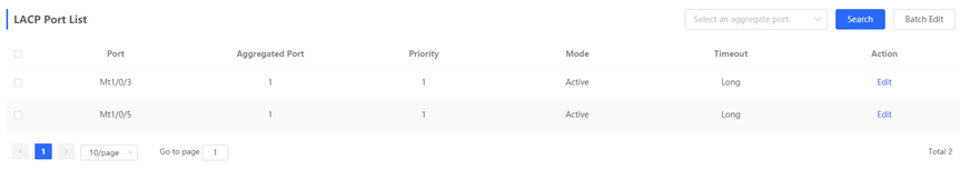

3. Choose Local Device > Ports > Aggregate Port > LACP Settings > LACP Port List.
The LACP Port List page shows the port ID, priority, mode, and timeout mode of each LACP-enabled port. You can view the member port details of the corresponding link aggregation group by selecting an aggregate port.
You can select a specific port and click Edit, or select multiple ports and click Batch Edit to modify the port
priority, mode, and timeout mode in the pop upwindow. Then, click OK to confirm and apply the changes.

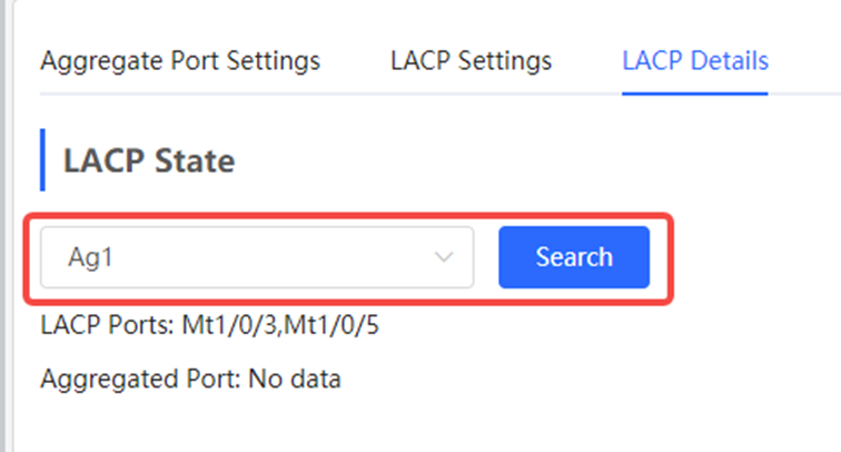

View LACP State
Choose Local Device > Ports Aggregate Port>LACP Details. You can select an LACP enabled aggregate port and click Search to view the LACP enabled member ports and the aggregate port information on this page.
