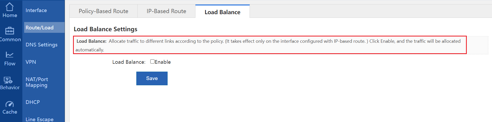

For Ruijie EG, the load balance takes effect only on the interface configured with IP-based route.

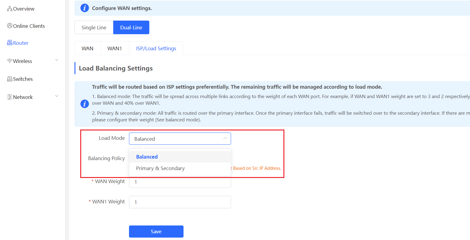

For Reyee EG, it's Load balance supports 'Balanced' and 'Primary&Secondary' mode.

Hi sir, sorry for not reply timely.
'Balanced' and 'Primary & Secondary' is different control policy. We suggest you configure it according to your requirement.
