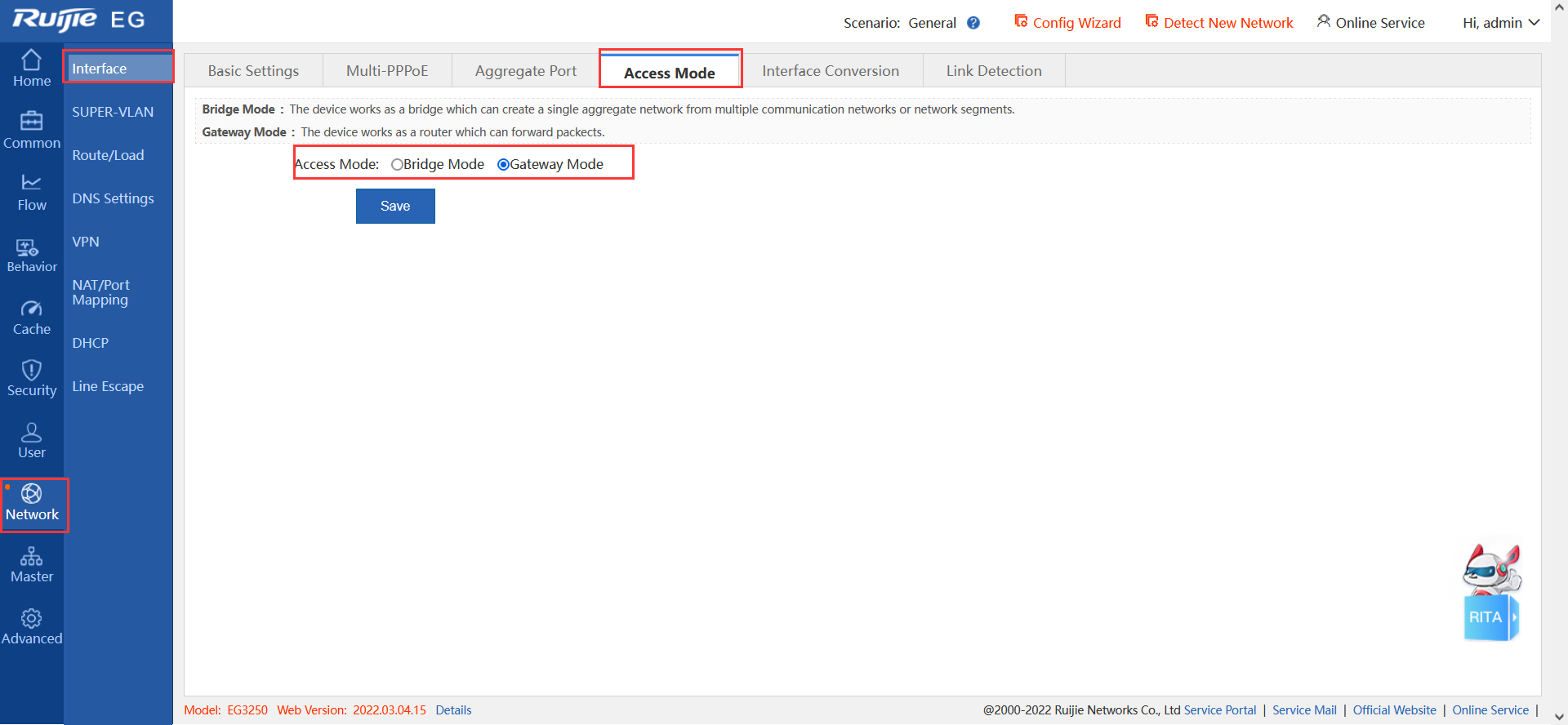

How to change the work mode of the Ruijie EG? Reply
3350 0 2022-6-28 15:20:46
Click Network > Interface >Access Mode, select the required access mode, and click Save. The device will switch to the selected mode successfully after restarting.
