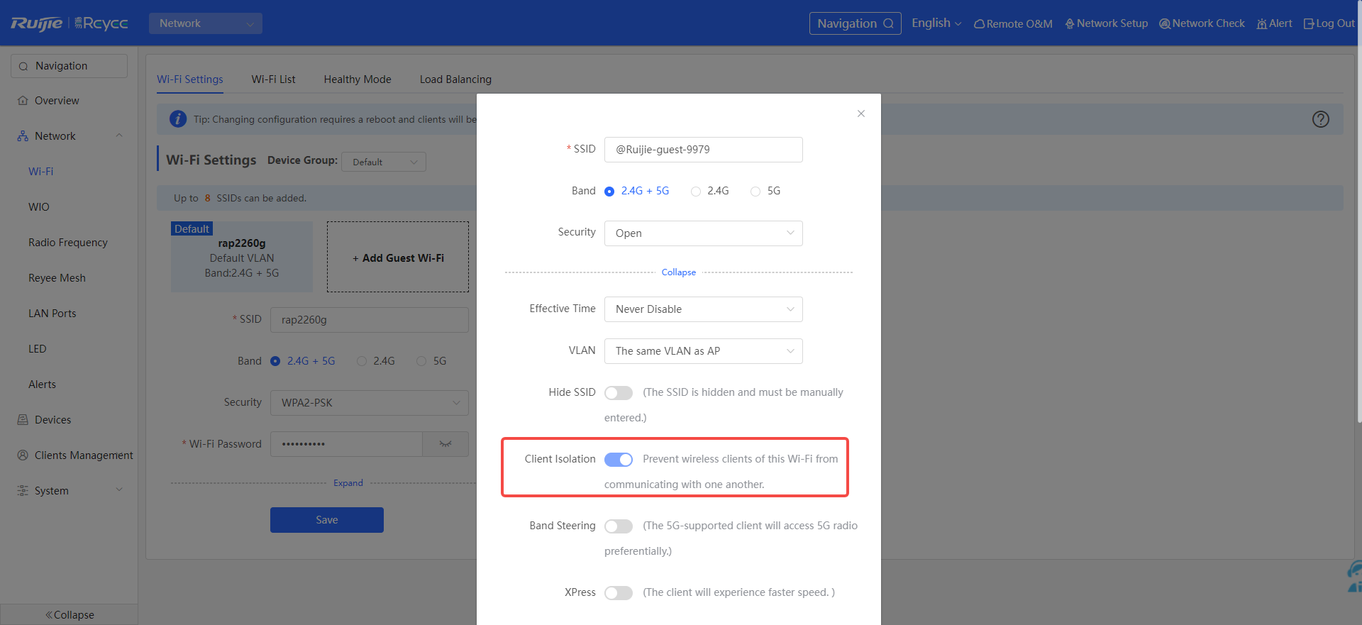

Sorry for the inconvenience , EG is not support isolation base on vlan , you need configure it on AP
Ruijie AP:
Ruijie(config)#wids
Ruijie(config-wids)#user-isolation ssid-ap enable
Ruijie(config-wids)#exit
Reyee AP :

So we have to create ACL rule for each and every IP address in a VLAN to establish the client isolation right?
0 2023-3-2 13:16:14 View all replies
The Wi-Fi Hero replied at 2023-3-2 00:18
So we have to create ACL rule for each and every IP address in a VLAN to establish the client isol ...
Sorry , ACL cannot block access to users on the same network segment ,You need to enable the isolation function on the AP to prevent mutual visits between users on the same network segment
