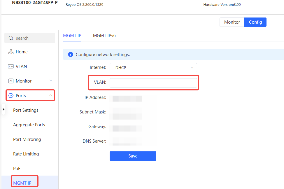

Dear Ghali Haythem,
You may change the management VLAN of the device on the management IP configuration page:

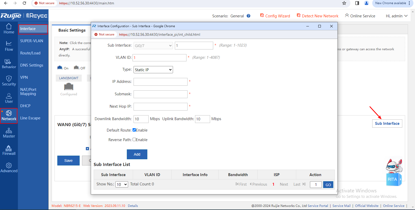

NBR 6205-E:
On Ruijie EG, you can change the

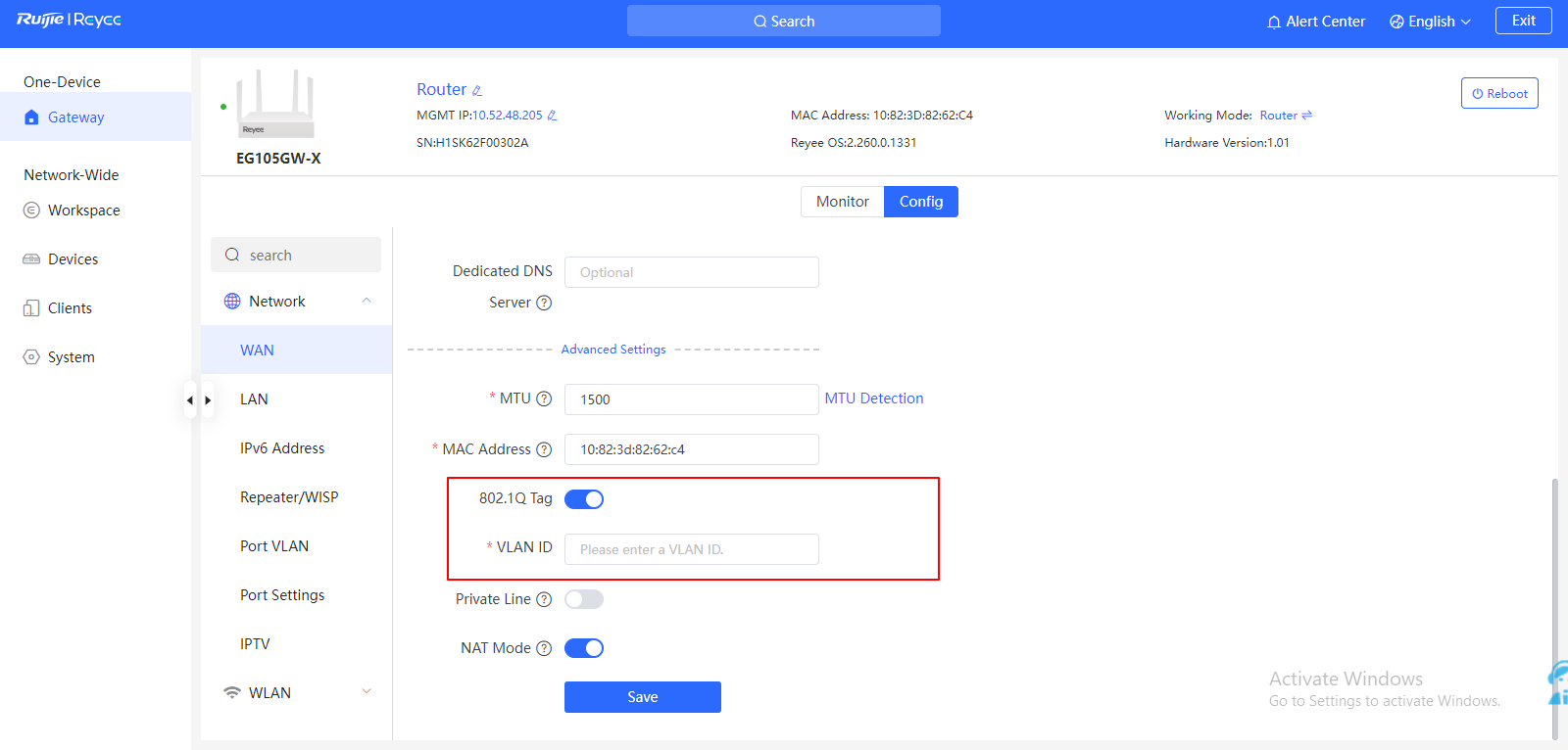

EG310GH-E (AC mode) :

Yes, AP, NBR 6205-E, EG310GH-E (AC mode) also support changing the management vlan. You  ...
