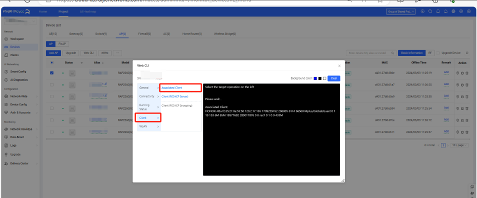

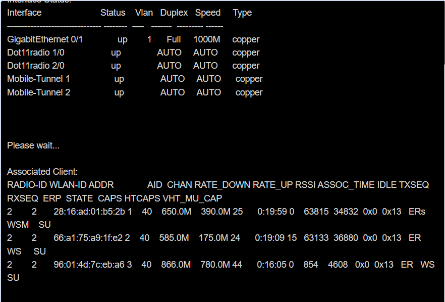

View the RSSl value of the wireless user on the AP:
    Network > Devices > AP > Web CLl;
   Click> Assiciated Client
Note: In Ruijie AP, the RSSI displayed by above buttons means the received signal strength with the range of 0 to 100 ( the corresponding wireless user signal strength is equal to displayed RSSI minus 95. For example, the above figure RSSl 51, the corresponding wireless signal strength is 51-95 =-44dBm).
If the RSSl value is lower than -60, it is recommended to make the terminals closer to the AP or increase the power of the AP appropriately to allow the terminals to obtain a higher RSSl value.

As shown above, at this point the user is connected to the 5G SSlD with a negotiatedrate of RATE DOWN 173.0M RATE UP 173.0M.
Checking the Current Channel Width Configuration.
Adjust the 5GHz Channel Width 40 and then take the speed test again to check the negotiated rate.
It can be seen that the negotiated rate is higher than when the 5GHz Channel Width is 20M.

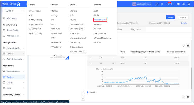

6. Channel congestion

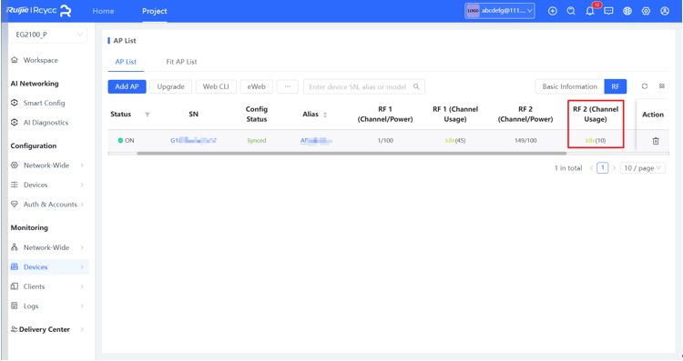

View the utilisation of the channels currently used by the APs.
ldle: 0 per cent-59 per cent.
Busy: 60-79 per cent.
Overload:80%-100%,
When the state of channel utilisation is in ldle, it means that the channel currently used by the AP is more idle and the wireless interference is smaller, when the state of channel utilisation is in Busy or Overload, it means that the channel currently used by the AP is more congested and the wireless interference is larger, so it is recommended to change the channel used by the AP.

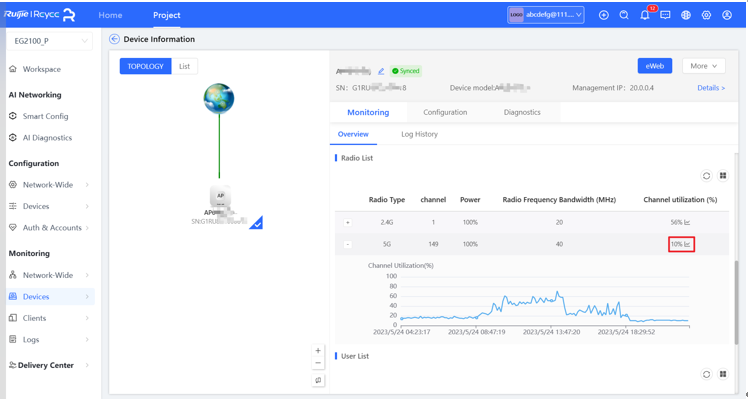

You can also view the historical channel utilisation by clicking SN to enter the AP details page.

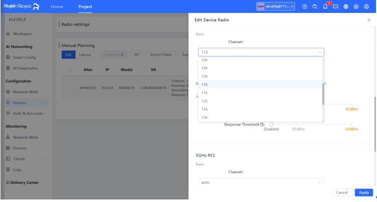

If the channel utilisation is high, try to change the channel and test again

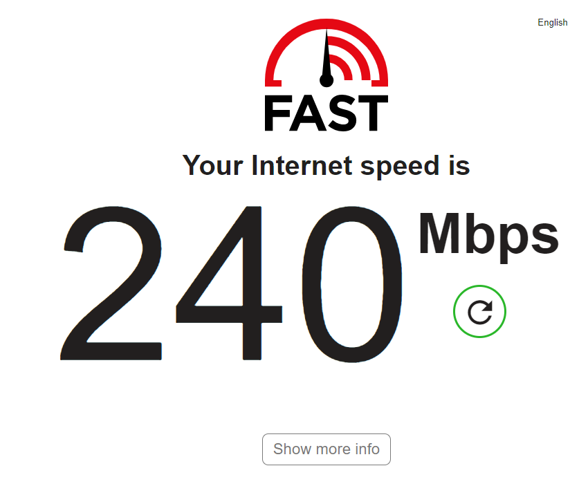

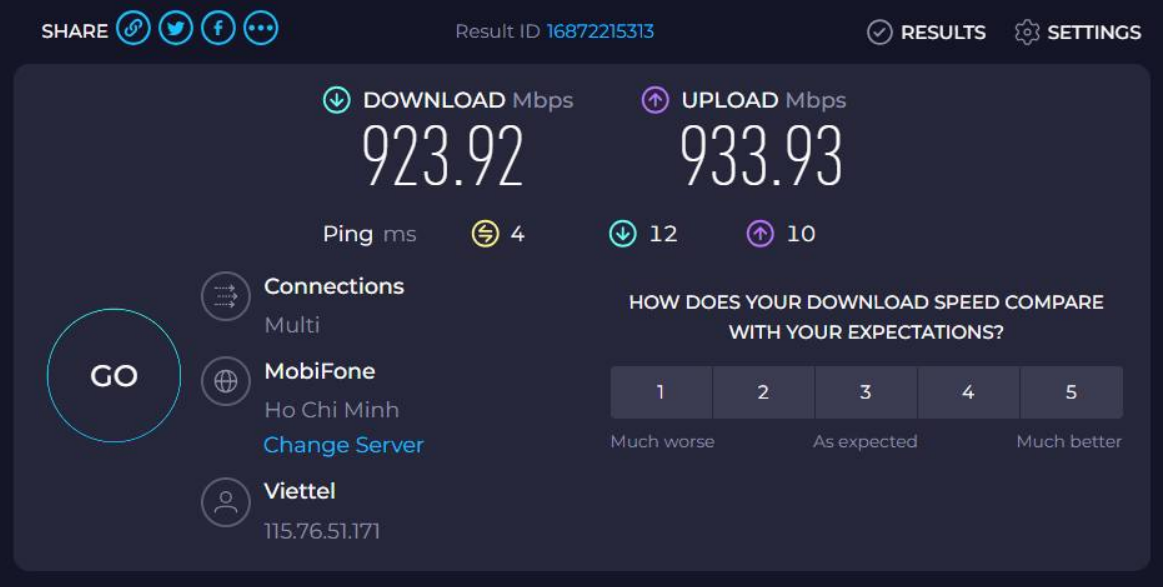

Hello Sir
In my model, The Internet - Converter - Draytek 2960F - Ruiijie RG-AP720-L. All LAN cables I'm using cat7 from Commscope.
I followed the instructions in the article above but the result only increased from 100mbps to 300mbps. While my bandwidth is 1000mbps (using Lan cable to test, it is 925mbps as shown below, but using wireless from RG-AP720-L is only about 300mbps).
When i tested with the LAN cable plugged into the Draytek2960F device
. When i tested wireless on the Ruijie AP720-L devide
Please take a look and help me.
Thank you.
