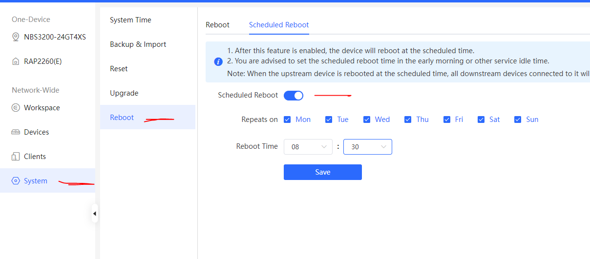

I installed a network of equipment formed by:
RAP2260 (e), nbs3200-24GT4xs, nbs3100-8GT2SFP-P
I activated the Schedule, through EWEB, every day at 0830 the apparatuses are renewed.
I had done this for Rap2260 (e) and nbs3100-8GT2SFP-P
This option automatically inherited it also for NBS3200-24GT4xs apparatus:
How is it possible to become this feature? Some apparatuses are others right?

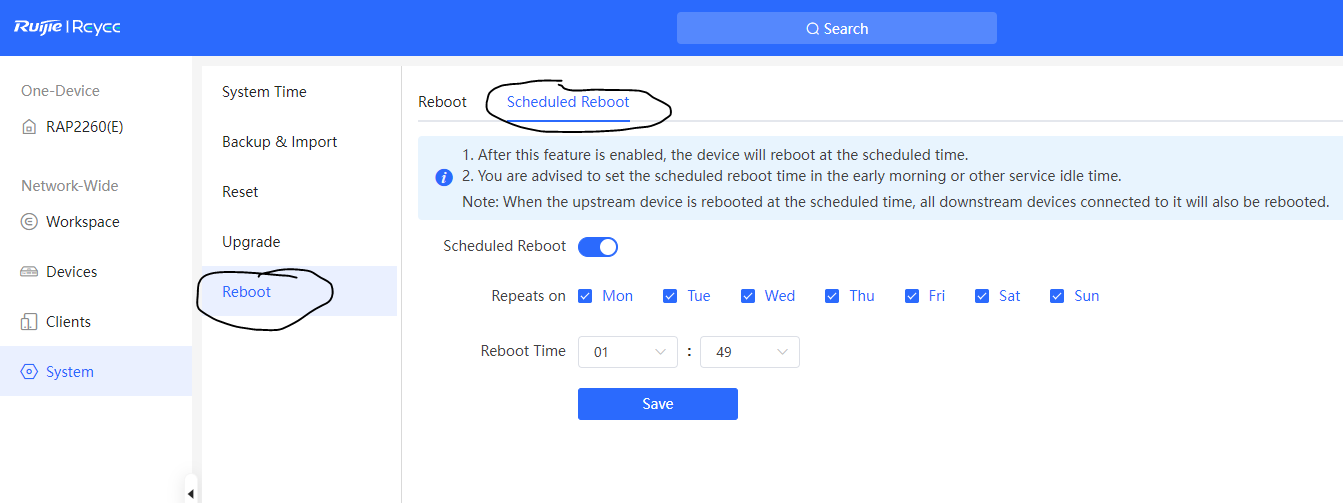

Hi,
in my project there are 3 device:
RAP2260(E) and NBS3100-8GT2SFP-P whit a schedule reboot (see image)
NBS3200-24GT4XS (I need to not restart with schedule)

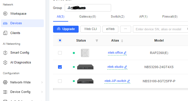

Hi,
I want to create a reboot diversified for each device, but when I do it, the configuration propagates also to the other devices belonging to the project!!

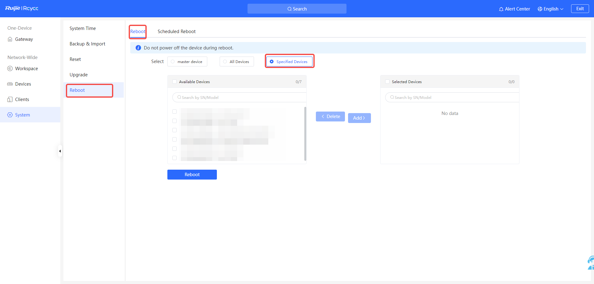

Hi, wallnas
Please note that scheduled reboot will apply to all devices in the same network.
Only the single reboot can be applied to selected devices:

Hi,
this is the procedure to reboot a single o a list of device in the moment.
I need to reboot device a a "Scheduled reboot".
In this option there isn't a possibility to select the single/group device to reboot.
How adjust problems ?

Sorry, scheduled reboot cannot support choosing AP groups currently, we are already made a demand for our team to improve this in later device software.
