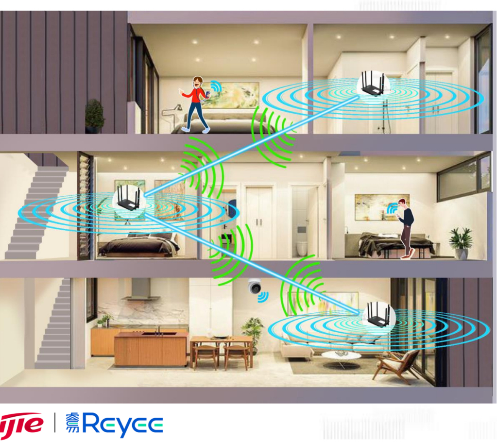

Hello these,
I just bought 3 EW1200, I want to configure mesh following pic below.
1 Master - Ground Floor.
Slave 1 - First Floor.
Salve 2 - Second Floor.
However, Slave 2 is too far Master.
Any solution to configure? Or can I configure mesh between Slave 1 and Slave 2.
Many thanks for your advice !!

Dear Khoa,
The slaves will be connected to the master. It is not possible to add a slave to another slave. What you can do is increase the transmission power of the radio frequency of the master and the second slave so that the values between them are optimal.
