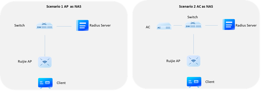

1. Topology

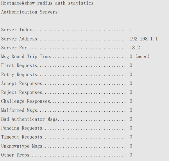

Ping the RADIUS server IP address using the source address (NAS address) and check the output. This step is supplementary. If the ping fails, it may not indicate a connectivity issue, as the server might have ping responses disabled. Use the output of the show radius auth statistics command in the next step to assess connectivity more accurately.
2. Run the show radius auth statistics command to display the statistics about packets exchanged between the NAS andthe RADIUS server.
If the value of the Requests field increases, the device is sending RADIUS packets.
If the value of the Responses field increases, RADIUS packets are received. If not,check the connectivity between the NAS and the RADIUS server.

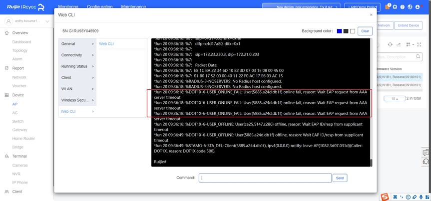

Check the debug logs (Do not run the debug command directly if services have been running onthe device.)
terminal mon
terminal length 0
debug dot1x event
debug dot1x error
debug aaa all
debug radius all

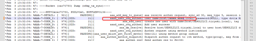

3.4 Clients Frequently Using Hostname + Domain Name for Authentication inAD Scenarios
In AD scenarios, before the user enters their username and password in the NIC pop-up window, the PC initially uses the computer name and domain name as the authentication username and sends it to the server. This can lead to authentication failures.
When some clients fail authentication, the authentication page does not automatically display, which results in authentication failures.
In AD scenarios, you are advised to run the following two commands before performing the test again:

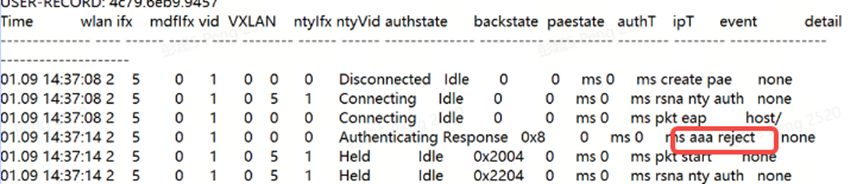

3.5 Authentication Rejected RADIUSServer
Run the showdot1x user diag mac XXX (client MAC address) or debug command tocheck whether aaa reject is displayed for authentication failures.
Output of the debug command
Possible causes and handling suggestions:

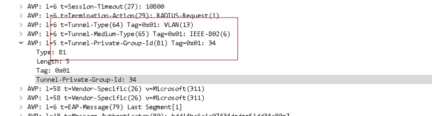

2.5.3 Missing RADIUS Attributes or Incorrect Format of RADIUS Attributes
The RADIUS server may need authentication request packets to include specific attributes or follow a certain format. This type of issue is difficult to diagnose due to the involvement of third-party integration requirements. It requires joint troubleshooting with the RADIUS server engineers. If the issue involves device replacement or initial setup, and it worked normally before the replacement or migration, test with the same account in both the normal and faulty environments. Capture and compare the packets from each environment, and verify that the RADIUS attributes and formats are consistent.
In the following case, the RADIUS server delivered a dynamic VLAN attribute, but the NAS is not configured with dynamic VLAN and could not recognize the attribute, resulting in authentication failures.
The RADIUS server (ClearPass) delivers a dynamic VLAN with the VLAN ID 34.
On the device (AC in this case), configure a VLAN group (dynamic VLAN function).
SQL
##Configure]vlan-group 1
default-vlan 1
wlan-config 2 clearpass_1x_dynamicvlan
interface-mapping 2 group 1

If the timeout is caused by a link failure, you can run the following command tochange the timeout interval:
dot1x timeout server-timeout xxx (Default: 5s)
radius-servertimeout xxx (Default: 5s)
radius-serverretransmit xxx (Default: 3 times)
