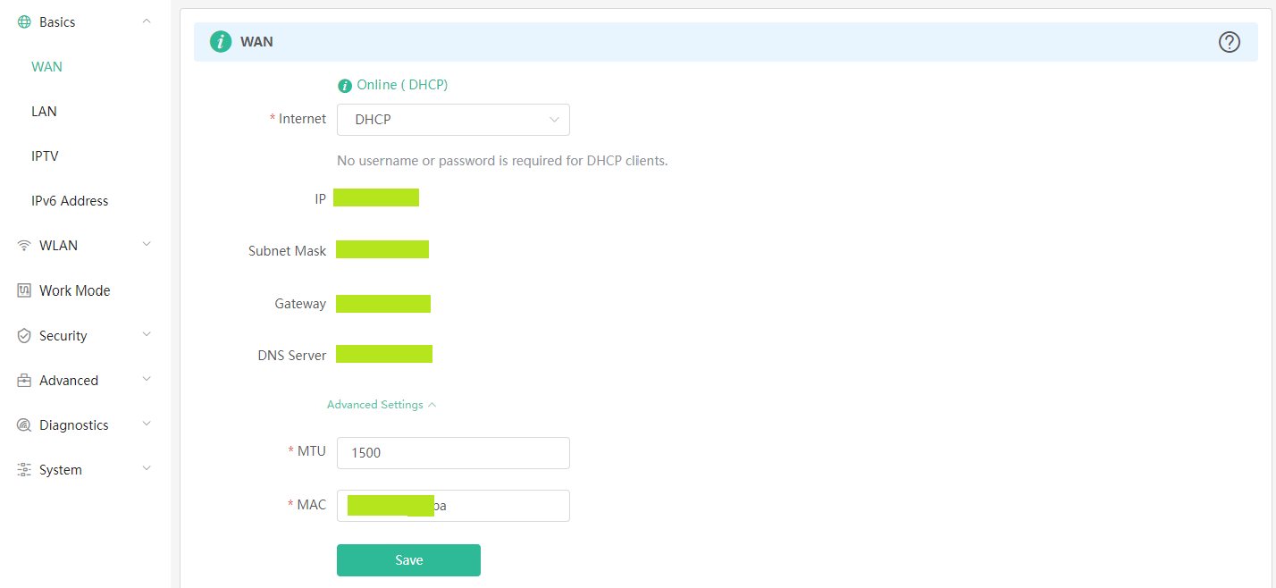

My ISP requires PPPoE via VLAN to access the Internet, but I did not find this setting "More > Basic > WAN > Advanced Settings >802.1Q"
in EW3200GX PRO , please help me solve this problem.

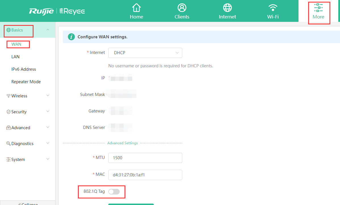

You may find the 802.1Q configuration on the EW refer to this picture
Ross
0 2024-7-10 13:59:57 View all replies
GTAC-Ross replied at 2024-7-10 11:50
But I can't find 802.1Q configuration on RG-EW3200GX PRO, please see my picture

User 36996 replied at 2024-7-10 13:59

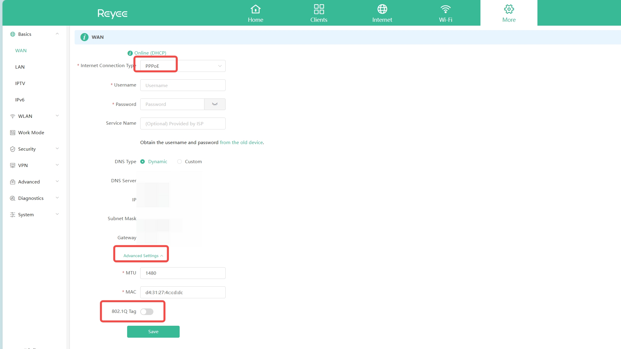

May I confirm when device switch to other modes, the 802.1Q option can not display too
If so May I confirm the current firmware version of the device
so we can confirm if device works in the latest firmware version

When I switch to PPPOE modes, the 802.1Q option also not display too...
My current firmware version is ReyeeOS 1.226.2123
