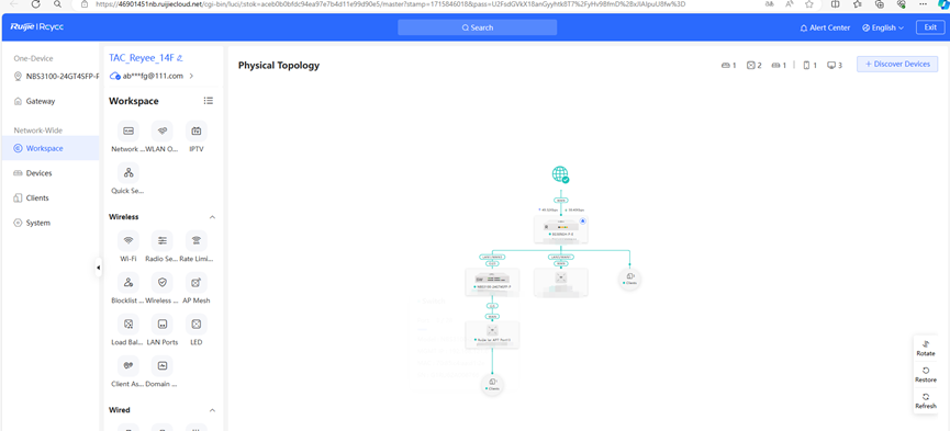

2) Method 2: If your device is online on Ruijie Cloud, you can create a tunnel on Ruijie Cloud to log in Reyee switch.

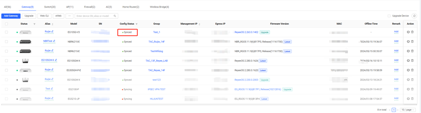

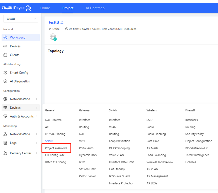

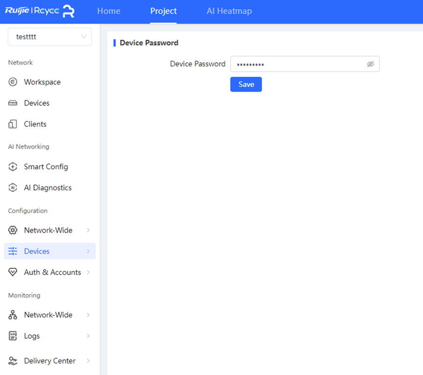

Step 2: Check that the project password on the Cloud matches the customer's current password. If the device is online, the user's login password is the same as the project password.
Check whether the password of the cloud device is synchronized normally, if not, please click Manually Deliver to manually synchronize the password, after the synchronization is successful, you can use the project password to log in to Reyee switch.
