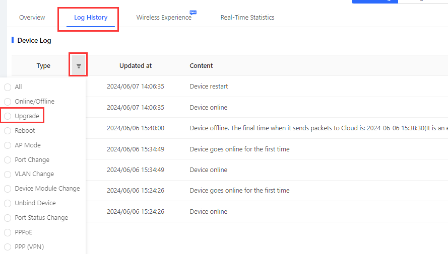

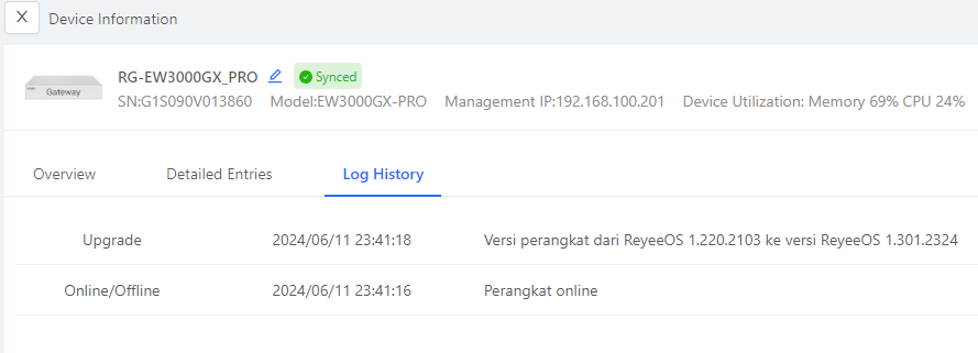

As for the version you need, there is no version of 220 for this model, could you please check it again? Is there any upgrade log that you can screenshot for us?erwin weah replied at 2024-6-12 09:56

May you show me your current test environment and the configuration on the device and let us check it for you? You can take screenshots of the following pages:
According to your requirements, I can send the version you need to your email. But there is no version of 220 for this model, could you please check it again? Is there any upgrade log that you can screenshot for us?

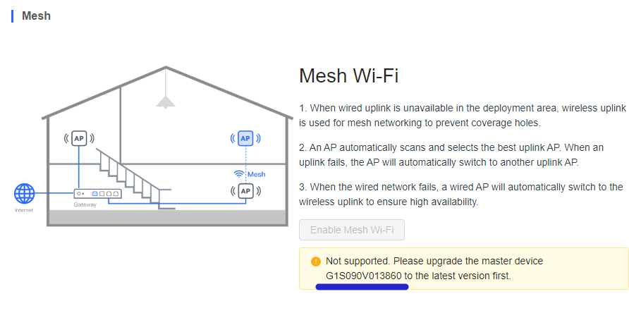

it said the EW3000GX with firmware ReyeeOS301 not support AP Mesh
0 2024-6-13 08:40:28 View all replies
erwin weah replied at 2024-6-13 06:03

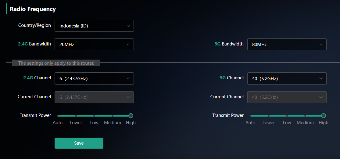

I found the problem, it is because I used different channel, not firmware update.
After I set same channels for 2.4Ghz and 5Ghz the roaming is working great but ping is high and there are packet loss.
Increasing roaming sensitivity help but not much.
The problem must be fixed by your company as soon as possible
because it is against what peoples said  "Channel must overlaps each other to avoid same frequency interference and packet loss" and "The Roaming is based on SSID not Channels"

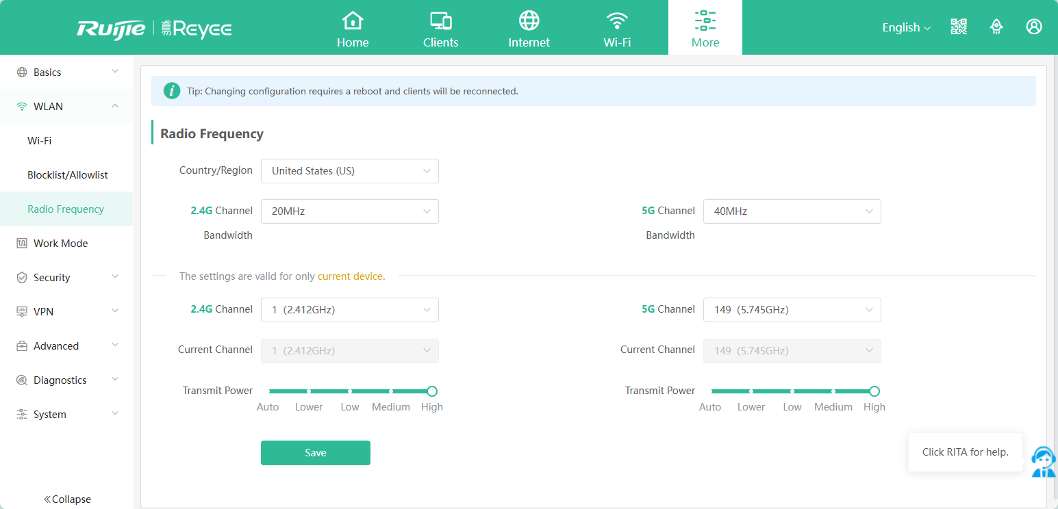

Tried different channels with
lowest power (25%) but it has no effect, it switch after very poor quality of signal -85 dbm (6 Mbps) while with same channel it switch in -60 dbm (200 Mbps)

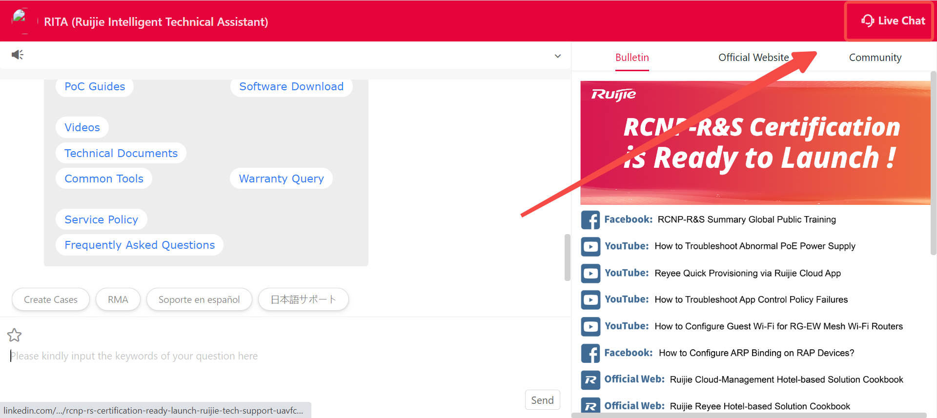

Dear,we have understood your issue briefly. In order to locate and solve it more quickly, would you mind coming to rita to communicate with our engineers to solve it in real time?
You can access our RITA platform at the following website link: www.ruijienetworks.com/rita
