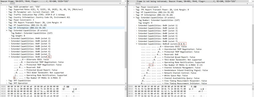

The NICs on Windows 7devices cannot parse the A-MSDU field in the new firmware version, which prevents them from recognizing beacon frames with Extended Capabilities(including the MSDU field) that exceed 8 bytes.
The left figure shows an A-MSDU value of 0 in the W1B4 version, while the right figure shows an A-MSDU value of 3 in the W3B1 version.
