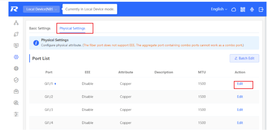

Can you describe your problem more clearly? What are your current problems?
If you need to configure the port, you can refer to this picture:
