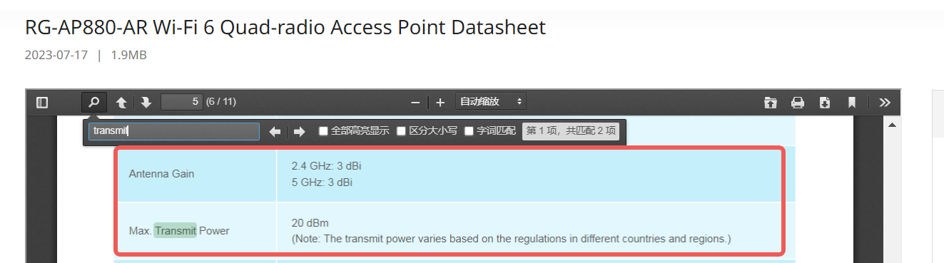

Hello,
For AP880-AR, plz refer to the picture below:
For AP840I, plz refer to:
and, the percentage for power correction need to be calculated for milliwatts.

Thank you, Stella, for the prompt response and the useful information provided.
Let me to perform some tests and measurements.
