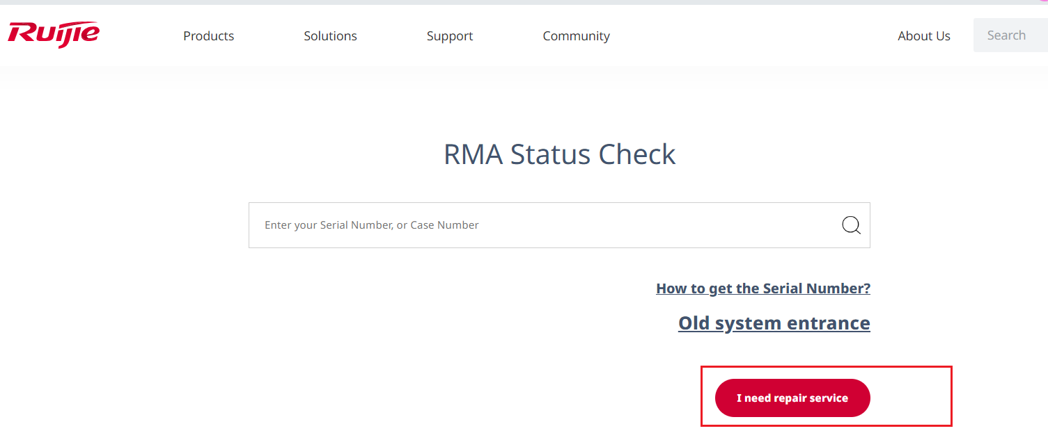

Hi sir,
Was there a power outage when you upgraded. If so, the issue may firmware lost, Did you try reset the RAP? If there is no response to restore factory Settings, the default SSID cannot be searched, and the wired connection does not respond, it shoule be the firmware is lost.You can apply RMA via this link:https://www.ruijienetworks.com/support/rma/
