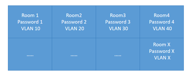

1. Introduction of GPSK
The GPSK function consists in mapping the every single password to VLAN for the same ssid:

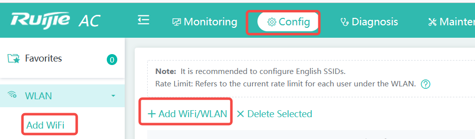

a)Configure SSID, click Config>WLAN>Add WiFi>Add WiFi/ WLAN
Enable the PPSK option when configure the WLAN, and click Next

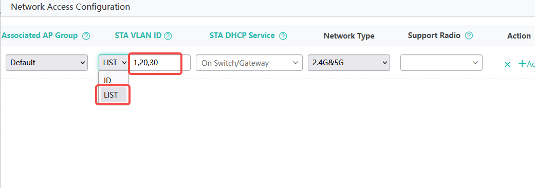

On next page, select LIST as below, and fill VLAN IDs whiches are mapped to different password for each room then click Finish.
