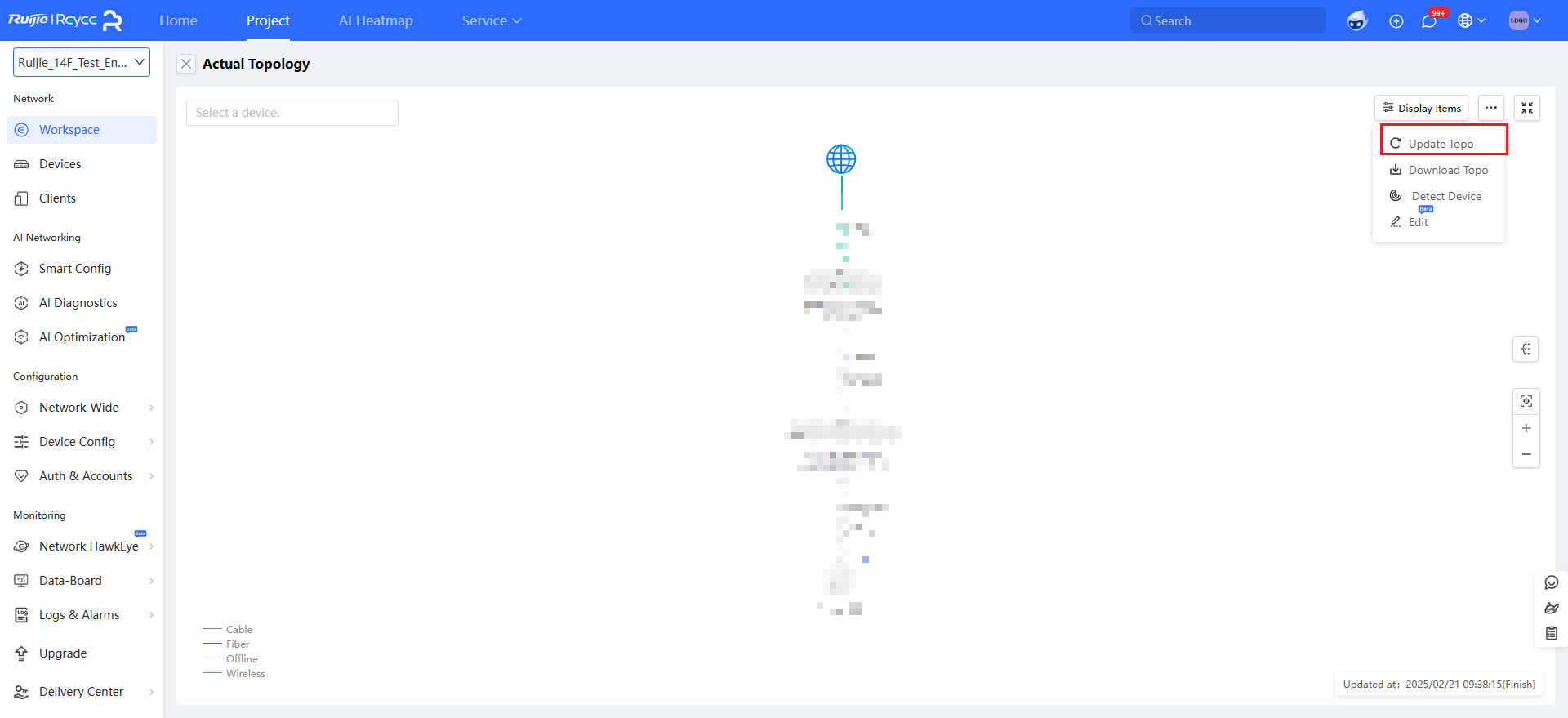

Hi sir,
Could you please provide the issue screenshot?
Sounds like topology not display normally,right?  If so, you can refer to these steps to troubleshooting:
1.Please check whether the AP online on cloud, if not, you can refer to this link troubleshooting:
https://community.ruijienetworks.com/forum.php?mod=viewthread&tid=3290&extra=page%3D1
2. if all device online on cloud, please click updata topo, then wait 3-5mins
3.Enter the EWEB and check whether the EWEB topology is normal.
If the MACC topology is abnormal due to the inconsistency between sys mac and wan mac, the EWEB topology is normal.
4.Confirm that the wan mac of the device (below the image) is sys mac (above the image) +1
5.please confirm whether your device is the latest version, if not, update to the latest version
6.If still have issue after you doing these troubleshooting steps, please contact us via RITA,so we can reply you in time:RITA Robot/Live Chat: www.ruijienetworks.com/rita

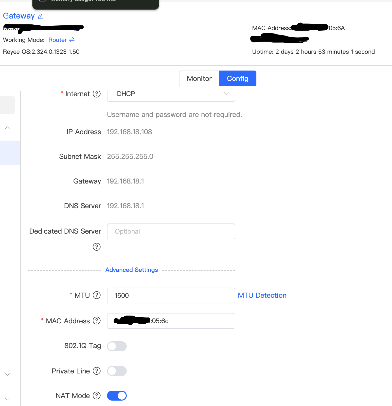

AP_Lantai_1 and AP_Lantai 3 is detected on virtual device, not physical.
How to change or remove the virtual device that, just as two other AP like  AP_Lantai_2 and AP_Lantai_
WAN - from ISP
LAN0 - to another switch that connect to IP Camera
LAN1 - AP_Lantai_1
LAN2 - AP_Lantai_2
LAN3 - AP_Lantai_3
LAN4 - AP_Lantai_4
Additional note : all AP and gateway already on latest firmware
the WAN Mac and Sys Mac on the gateway is different one digit,
sys mac :05:6A
wan mac :05:6c
but i cant check the ap eweb using tunnel since always getting error…
