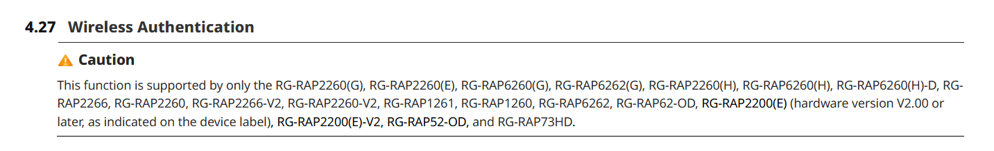

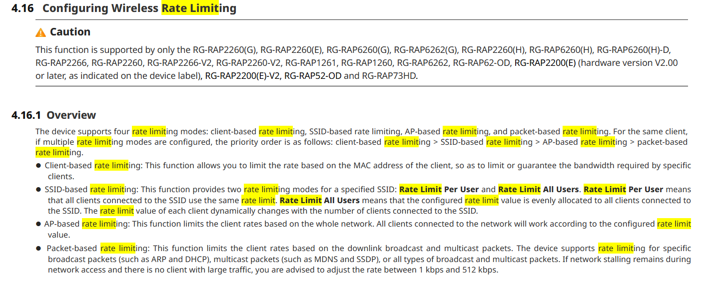

Yes they support rate limit by client and captive portal. You can refer to the configuration guide:

Hi, RAP2200E only hardware version V2.00 or later support captive portal and client rate limit,
the hardware version is indicated on the device label.
