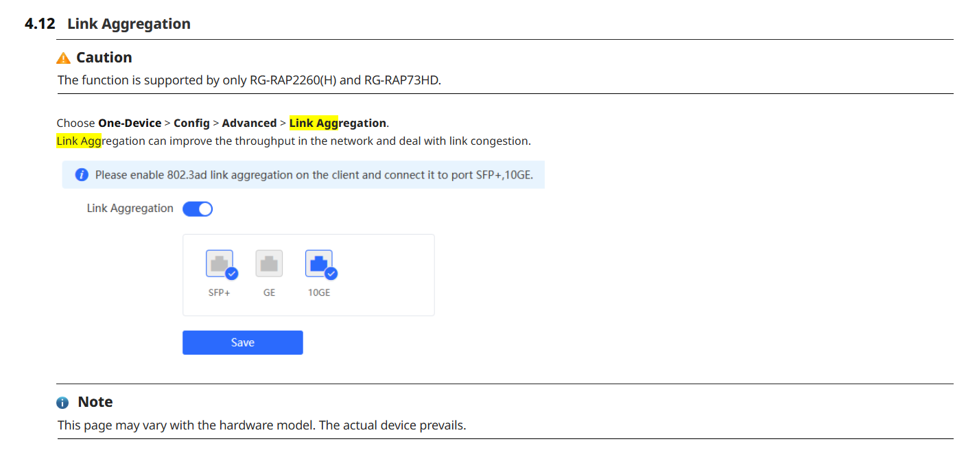

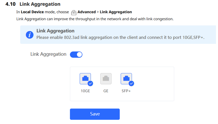

While many access points come equipped with dual LAN ports, only the RG-RAP73HD and RG-RAP2260(H) models support Link Aggregation (LAG).
Link Aggregation (LAG) can significantly improve network performance and reliability. This technology bonds multiple physical links into a single logical link and usually is used between two switches.
While many Reyee APs have two LAN ports, connecting them without LAG configuration can result in network loops. LAG requires specific hardware and software support to prevent these issues and optimize network performance. As of today, only two Reyee APs support the LAG configuration: RG-RAP73HD and RG-RAP2260(H).
To configure Link Aggregation on AP go to eWeb. In Local Device mode, choose Advanced > Link Aggregation. Next, indicate the ports that will be used as LAGs.
