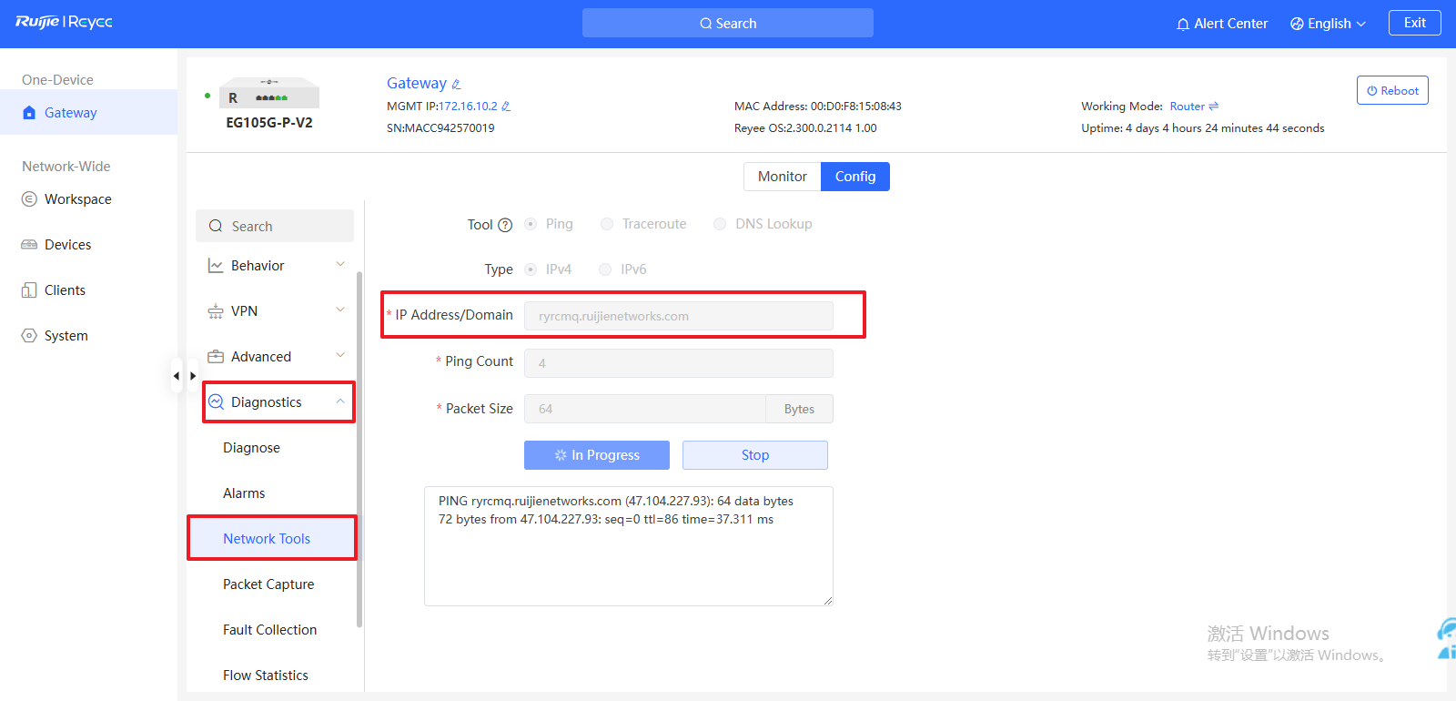

You can try to check the network connectivity between the cloud and the device. You can login to the device locally to ping the cloud address: ryrcmq.ruijienetworks.com to see whether it can be ping through by using the ping test tool via Diagnostics > Network Tools as the following picture shows:
