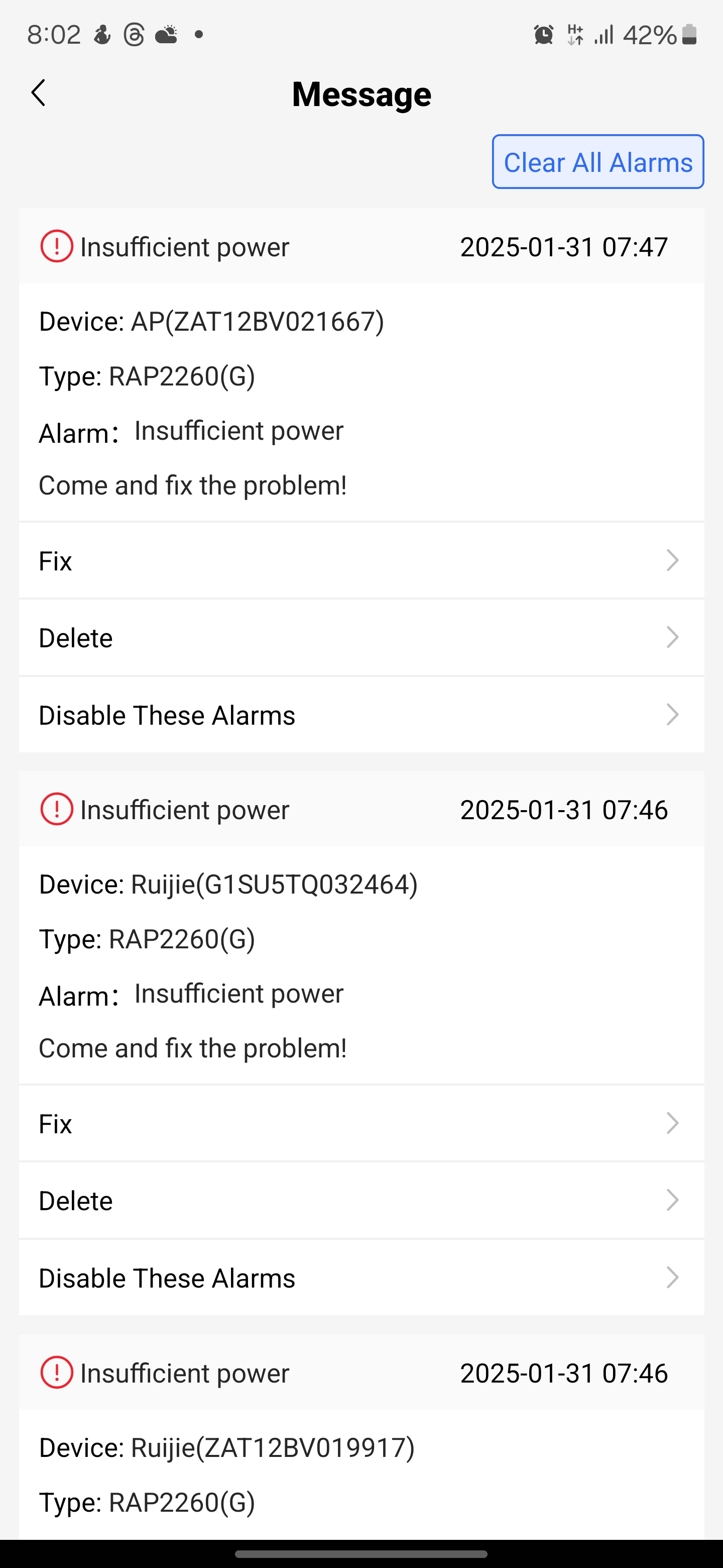

I have 9 RAP 2260(G) connected to a 24-port Cisco switch. It works, but I have insufficient power notifications.

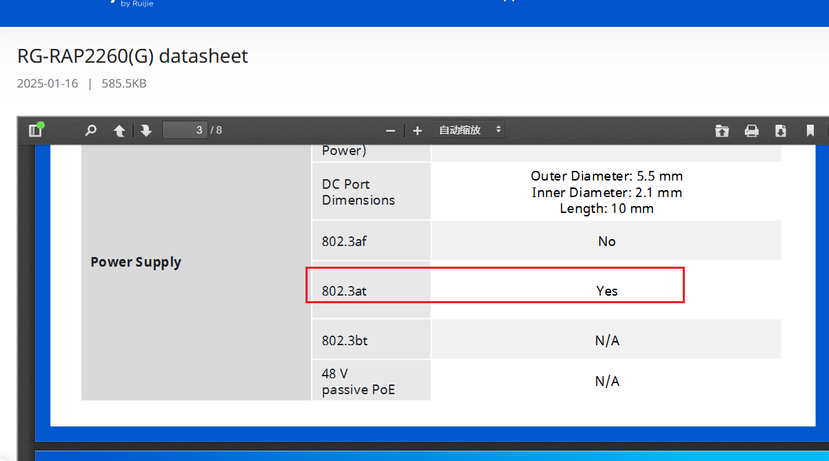

May I know the cisco switch's detail model?  Is the switch support 802.3AT? Coz the RAP2260(G) 's power supply is 802.3AT.

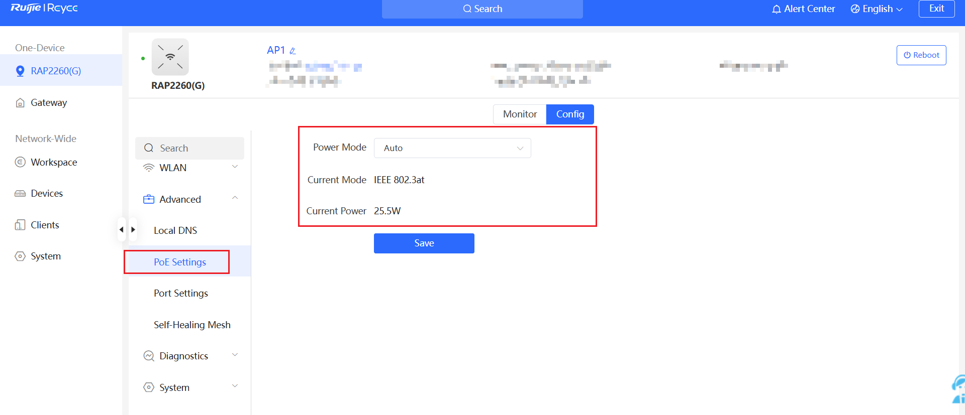

If the switch support 802.3AT, you can change the POE setting on the AP :
