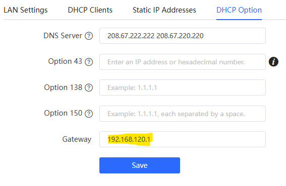

Hi,
I have problems here, my vlan gateway overrides with default LAN gateway. I think this is kind of bug with the firmware. Or you have solution for this?
In my case, My default LAN is 192.168.110.0/24 with gateway 192.168.110.1
I setup vLAN10 which the IP Subnet is 192.168.120.0/24 with gateway 192.168.120.1.
hovewer, if I connect my wired clients to local LAN ports, it's get the default LAN IP address, but with the vLAN 10 gateway! how to solve this? I want to segmenting my networks.
I'm using RG-EG210G-P-v3
Thanks.
RG-EG210G-P
Router
0 2025-2-10 11:50:43 View all replies
Hello there,
I think I made mistake here, and I don't know what gateway is specific use in the dhcp option is. But, after I remove the gateway address from that, it's working as expected.
Maybe, R&D team should give a clue to what's the use of it. Or, should they add more specific dhcp setup, like custom gateway address right? so we can more flexible to setup the networks.
0 2025-2-10 18:53:56 View all replies

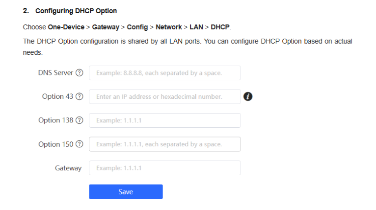

Dear
It is the IP address of the default gateway or default route that the DHCP server assigns to clients. The default gateway is the next hop address used by a client to send data packets to an external network. It is responsible for forwarding the data packets to the target network.
You can check the following guide for more details.
https://reyee.ruijie.com/en-global/resources/preview/rg-eg-series-routers-reyeeos-2-324-configuration-guide/
0 2025-2-10 19:09:20 View all replies
