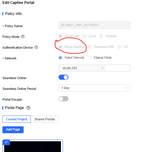

Hi. I have a system with 1x Reyee RG-EG105G v3 and 6 RG-RAP6262 (G) access points. There are 3 sites. First site has the Reyee RG-EG105v3 router and 2 access points, connected to starlink. Second site has 2x RG-RAP6262 (G)
access points connected to starlink. Third site has 2x
RG-RAP6262 (G)
access points connected to starlink as well. If all the devices are added on one project, is it possible for voucher authentication to work on the access points at site 2 and 3 when "Reyee Gateway" is the option selected on the captive portal???

Sir EG105G V3 doesn't support Gateway Portal Authentication, sorry about this issue. For more information you could come to reach us via RITA

I meant when that option is selected. I using it at site 1, and authentication is working. What I need to know is if I add RAP6262 Aps (which are directly connected to the internet) to the project, will authentication work, at those remote areas?????

Model  EG105G V3 doesn't support Gateway Portal Authentication, as mentioned before
