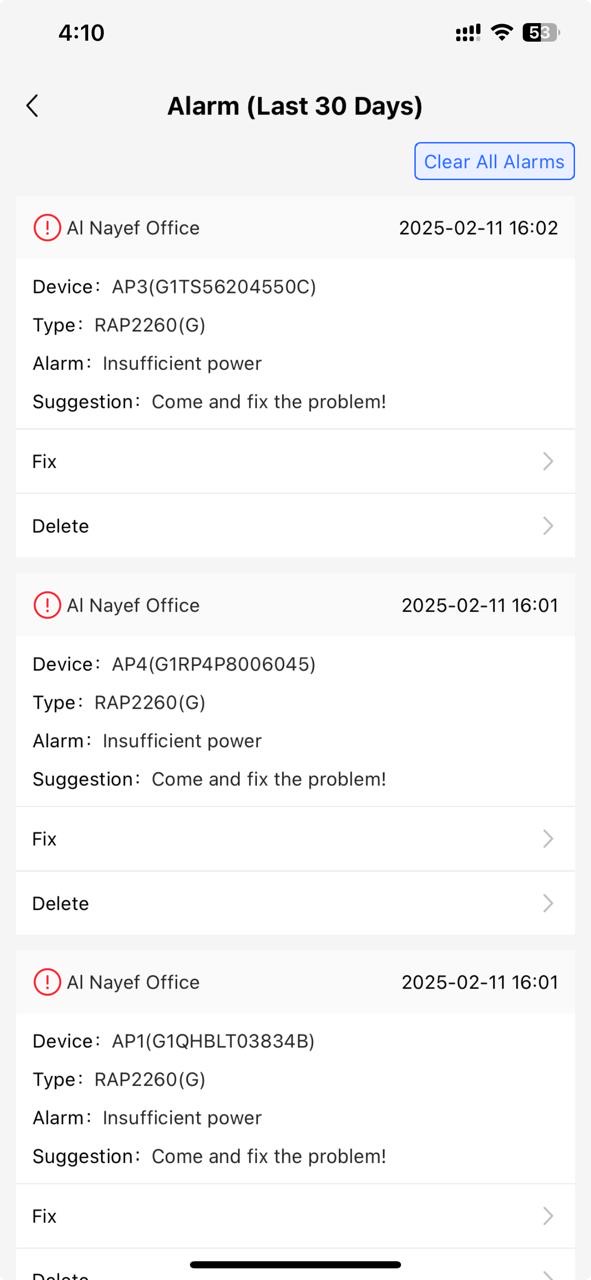

Hi ,
Here i have around 7 access points and they’re keep giving me this alarm insufficient power while I’m using poe switch dlink DGS-F1210-26PS-E
Please any advice.
RG-RAP2260(H)

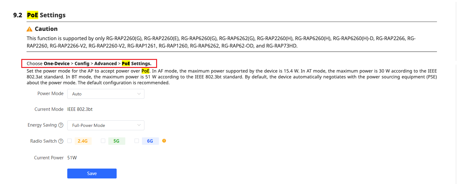

Dear sir,
Good day.
You can change the PoE standard to the highest one it can support on the AP eWeb to fix this problem:
