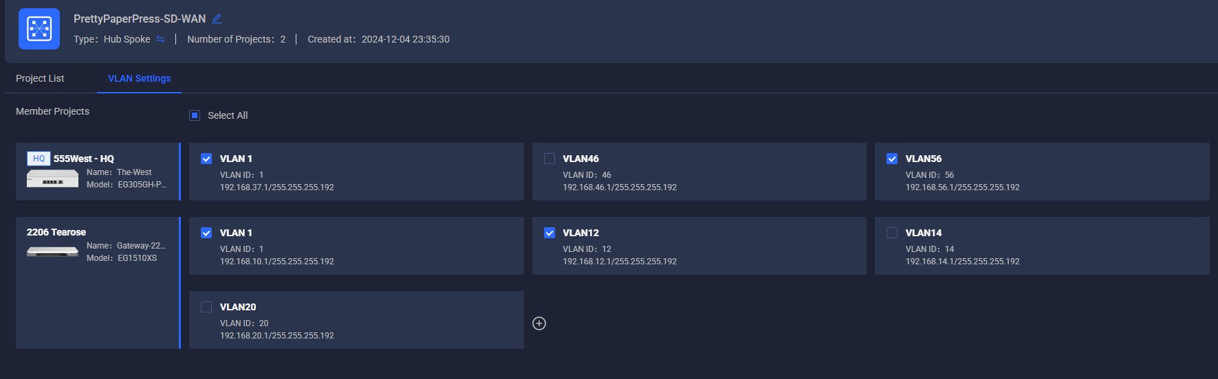

Is it possible to broadcast the HQ WiFi SSID in the branch office?
Can you assign a server with a HQ static IP address located in the branch office?
Thanks,
Alonzo

Hello,
1. Can you tell me which VPN type did you configure? Is SD-WAN? I have configure SD-WAN.
From the HQ, I am able to RDP to the servers in the branch office. I would to assign a static IP from the HQ subnet.
Can you broadcast HQ SSID in a branch office.?
2. What is your device model? HQ Model:EG305GH-P-E  Branch Model:EG1510XS
3. Can I know what is server address? 192.168.12.X
4. Will it changes dynamic then you need fix a static ip? the servers on the branch have a static

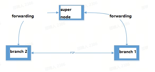

Dear customer,
The router does not necessarily need a public IP to establish the connection in our SD-WAN solution.
The success of the connection depends heavily on the NAT type of your network.
There are two methods for communication between two branches. One is direct device-to-device communication, referred to as the P2P direct connection method. The other is message relay via a supernode, referred to as the forwarding mode.
When neither branch has a public IP address (e.g., most residential broadband services lack public IPs), NAT traversal will be attempted. If NAT traversal succeeds, P2P communication can be established between the branches. Otherwise, communication must rely on supernode forwarding.
When does NAT traversal fail?
Currently, there are four types of NAT: full cone, restricted cone, port-restricted cone, and symmetric NAT. Due to the characteristics of NAT types, there are three combination scenarios where NAT traversal is theoretically impossible:
  • Port-restricted cone + Symmetric NAT
  • Symmetric NAT + Symmetric NAT
  • IP-restricted cone + Symmetric NAT
How to determine the type of NAT?
The NAT type is related to the outbound ISP, region, and link mode.
0 2025-2-19 13:20:21 View all replies

The AnyLink is configured and working. Can you expand a HQ SSID to the branch? Can an employee travel between HQ and Branch seamless connecting the corp wifi?
0 2025-2-19 13:28:25 View all replies
Mario replied at 2025-2-19 13:20
The AnyLink is configured and working. Can you expand a HQ SSID to the branch? Can an employee tra ...
Hello,
This feature is not currently supported. If you need, I can try to feedback to R&D team.
