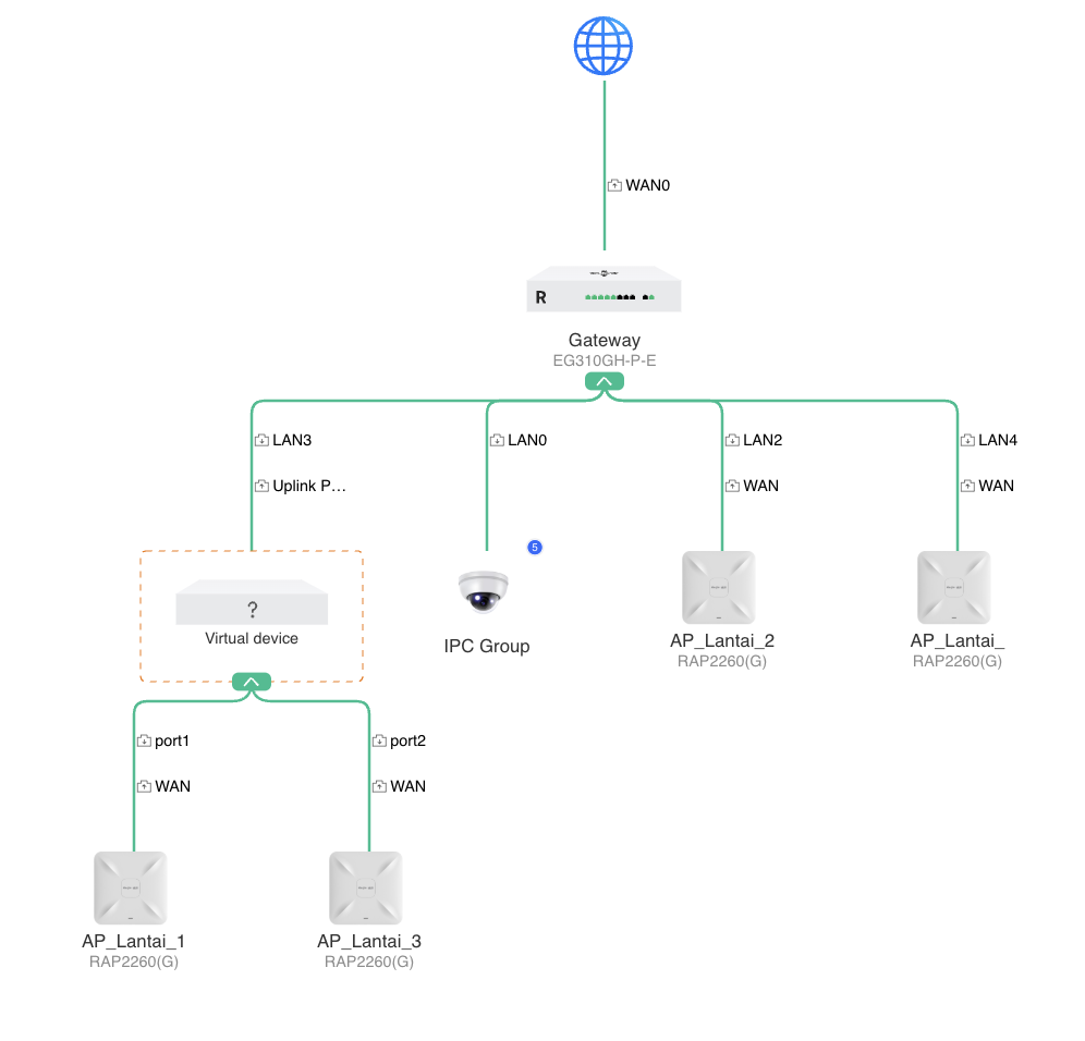

Hi,
there problem on my ruijie, AP_Lantai_1 and AP_Lantai 3 is detected on virtual device, but on physical there are no any device. How to change or remove the virtual device that, just as two other AP like  AP_Lantai_2 and AP_Lantai_
WAN - from ISP
LAN0 - to another switch that connect to IP Camera
LAN1 - AP_Lantai_1
LAN2 - AP_Lantai_2
LAN3 - AP_Lantai_3
LAN4 - AP_Lantai_4
Additional note : all AP and gateway already on latest firmware

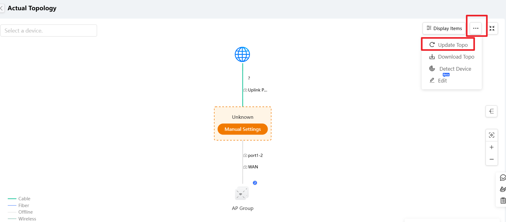

Hello,
You can click here and update topo.
