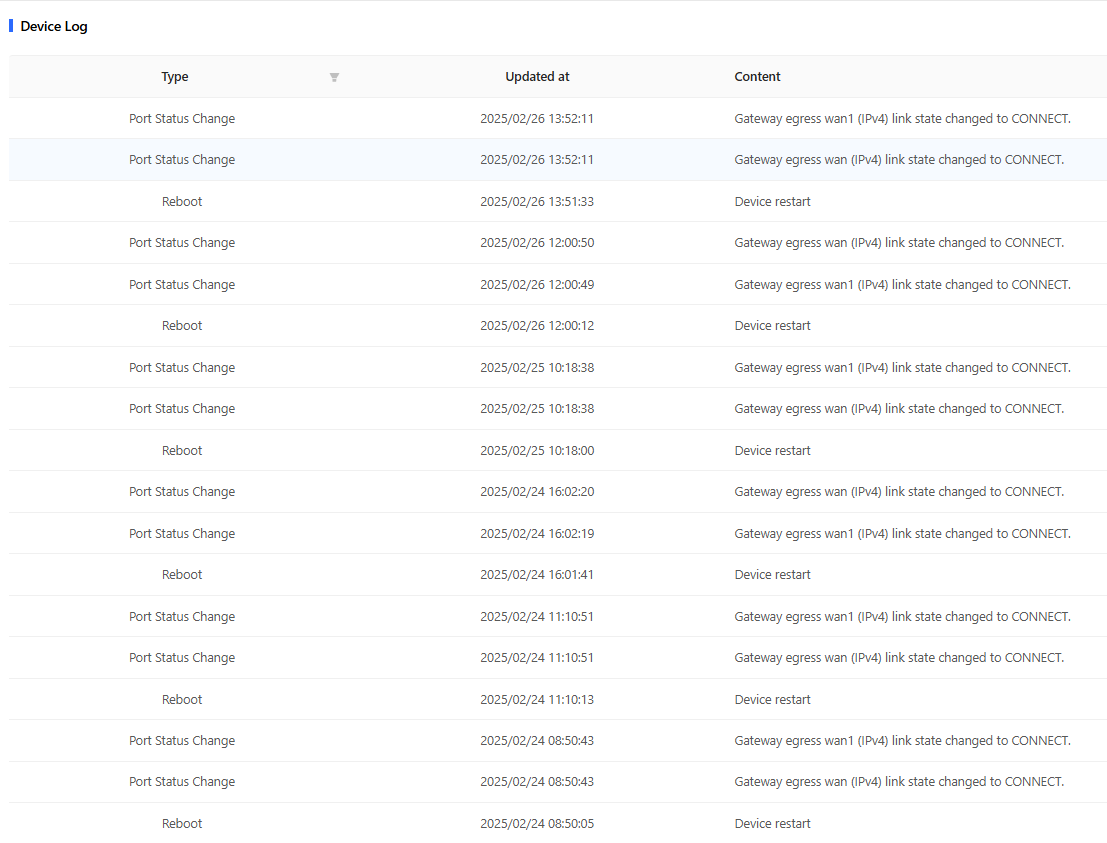

My gateway router always gets restarting, and it's always happening when crucial time. Reply
Trusty Hoister
4750 4 2025-2-26 14:07:34
What's the cause of this? It's always happening.

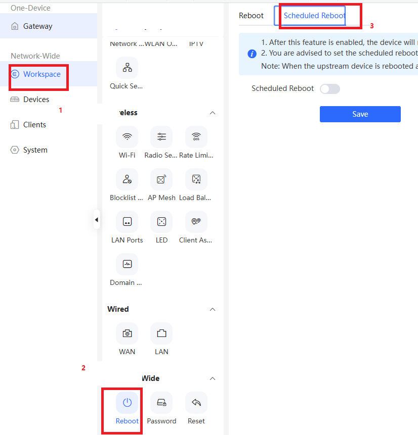

Dear customer,
It appears your device reboots frequently.

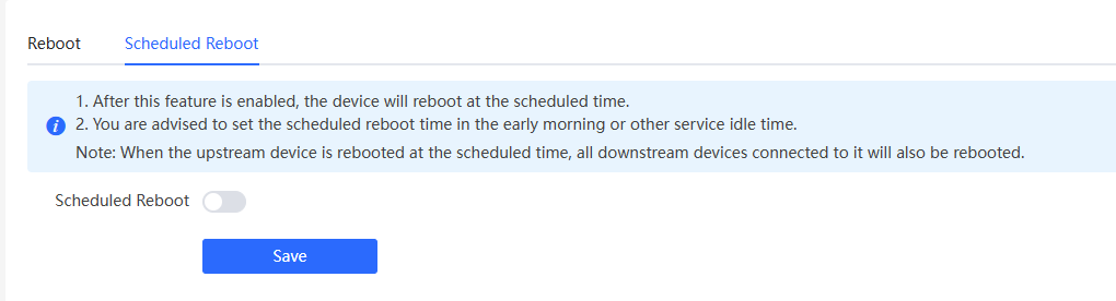

You can check if your device is configured with shceduled reboot in this page.
In addition, may I ask if it is powered with it original adapter?

It is disabled.
And, yes. It is the original power adapter.

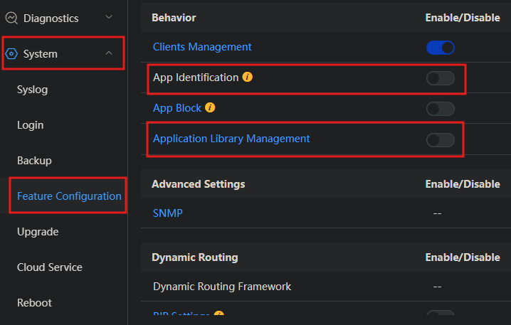

I just disabled these two.
